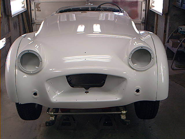

BOXoROCKS
Another of my never gets finished projects,a 57 TR3. 4 sets of louvers.

Did my attachment work? If so, you can see the louvers on my TR3.
