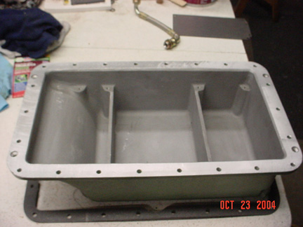

Has anyone considered adding baffles to the pan. It would certainly seem preferable to putting up with this design oversight. Attached is a pic of a properly baffled pan. There are small return slots in the bottom part of the baffles.

Dave,
Is that a pan you did yourself or did you find in on the web somewhere. I'm not tearing into mine till after this summer (hopefully) but would certainly like to add baffles when I have the engine out.

Jc,
It is a cast aluminum pan from Denis Welch - UK. The same ideas apply to any pan & baffles can be added. Even common old Chevies had pan baffles. There are likely aftermarket pans available for your car also.

jcatnite
Thanks, When I used to build Fords V8's for fun I would always get a deep sump pan with a high volume oil pump. Those pans would come with baffles but I never really thought about adding them to a stock pan. Perhaps these little pans aren't deep enough to give the oil that "slosh volume" that it needs.
