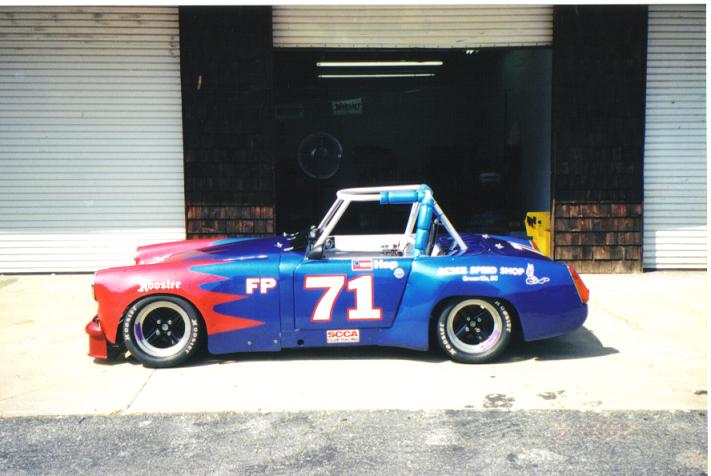

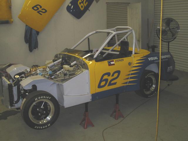

Here's a couple pictures of the cage we did in my FP car.
blkcorvair said:
Now that is impressive. I do like the cage in the Blue / Yellow HP car on your website.

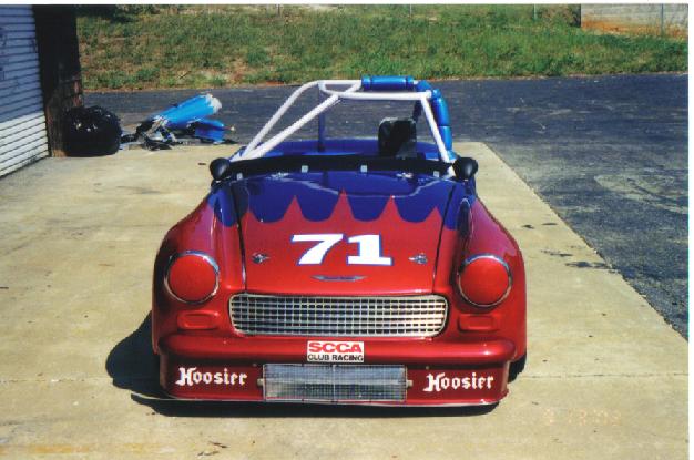

I thought I would share the picture with the rest of the crowd.
Very Nice indeed. I hope you don't mind I showed this pic to my local shop and said "Make me This!"
I'm gonna need your assitance on an MGB Su to bolt up to a 1500 Manifold (Similar to Nial's #11) This winter. I'm Planning to run this engine I have til I can get a nice 1275 put together.
Sure go ahead on the cage design, you're welcome to copy it.
As for running HS4s on a 1500, you need a Euro spec intake and carbs, I don't have a line on this, check with the triumph guys like TS imports, ted may be able to find you one. I can build the carbs for you though, once you have the set up, I've got a HS4 carb cores, but you need the intake, linkages to make it all work.
