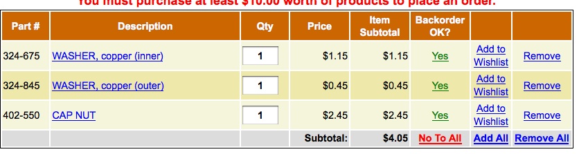

I found these parts on Moss Motors' website but I don't know if these are for the engine side of the oil line or the gauge side (or if they fit both sides). Anyone know?

I'm not sure from your description of where the leak is. The copper washers from Moss you refer to are to seal the oil pressure line take off near the oil pump. Often these copper washers can be annealed (heated red hot and then quenched in water) and then reused. The oil line goes over near the fuel pump where it connects to a flexible line, from the that to another solid line to the oil pressure gauge. All of these fitting are compression fittings. The smoothness of the compression fitting and mating surface really form the seal. If your leak is at one of these joints, open the connection and cleaning the surface and carefully reconnecting may seal it up. If it is leaking from inside the gauge, the bourdon tube maybe leaking. If this is the case, the gauge will need to be repaired.

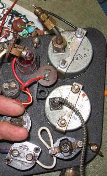

I have two connection fittings very close to the back of the oil pressure gauge on my 1958 TR3A. This photo is from 2007 but is how it came new in 1958.

Thanks for everyone's help! I have a replacement copper line en route from TRF so hopefully my mechanic will come up with the necessary gasket and make it stop leaking. I still drive the car and am enjoying the heck out of it (when it's not in the 90's as it has been lately!), but getting oil drips on my right leg and having to keep a rag on the transmission hump is getting old. I should have it all fixed this week, and if my mechanic runs into any problems at least I'll be able to show him all these helpful hints, so thanks again!
