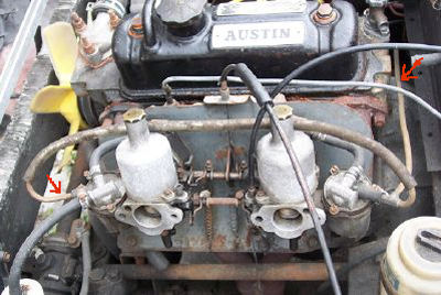

Thanks for all the advice. I will take the carb apart when the gasket arrives, have a look around and ask for help here if needed. My carbs have the little brass vent tubes - should there be an overflow tube attached??
The vent tube on the early carbs was a kind of banjo fitting at the top with a copper tube that bent down toward the ground. about 14 inchs or so long.
Latter models had I think a rubber hose that went down and still later had only a breather hole in the cap with no vent tube.
On the later carbs it is quite simple to create a home-made tubing set to route any overflow to the bell housing and back down to avoid fuel spillage onto the hot exhaust!
