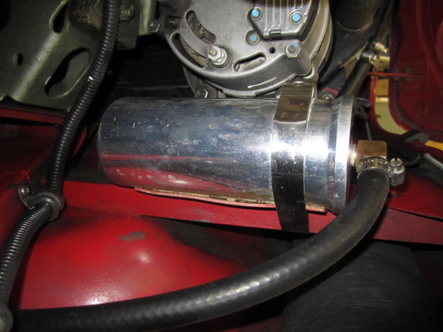

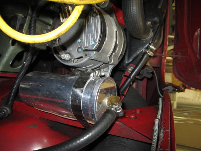

Michael Oritt
Drambuie--
You said: <span style="font-style: italic">"Also adding a coolent overflow bottle is a must on any old british car, As it keeps the radiator topped off to the brim and seals your cooling system. As apposed to dumping hot coolent through your overflow tube all over your healey and your driveway!</span>
An overflow bottle will not keep the radiator full, but a coolant recovery (this is probably what you meant to say) system will by retaining any coolant puked out of the radiator due to expansion in a bottle and drawing it back into the rad as the system cools down and contracts.
Michael Oritt
Here is the way I have one set up on the 100. In order to provide a good run for the hose from the radiator tank neck to the recovery tank I rerouted the metal pipe to lead to the right. Otherwise it is just a matter of finding the appropriate sized tank and mounting and plumbing it.
