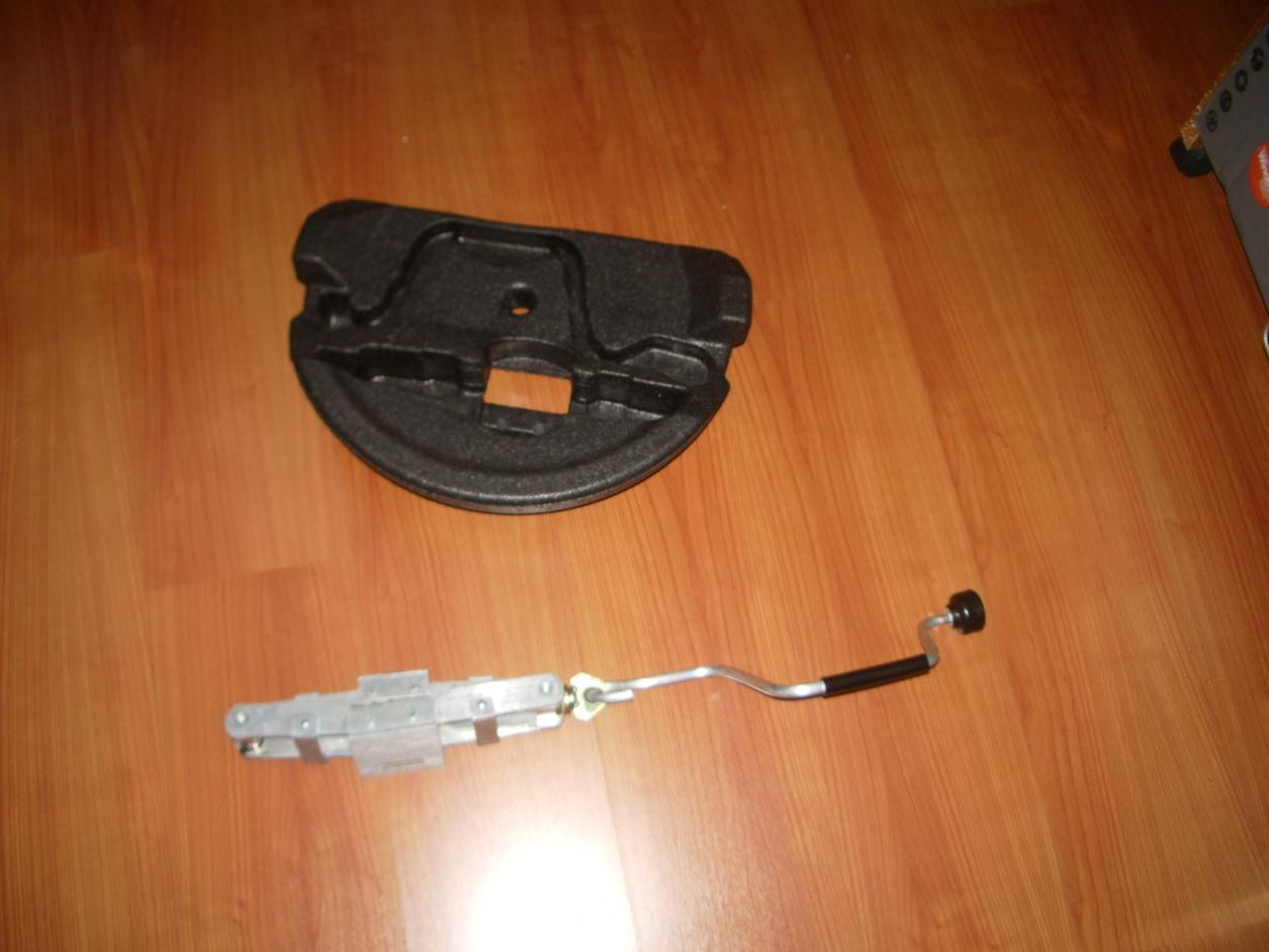

I can acquire one Boxster jack (all Aluminium) for my 100/6

Nice one! Its the same as for the 996.

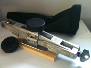

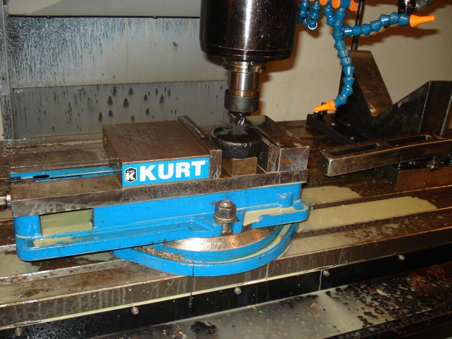

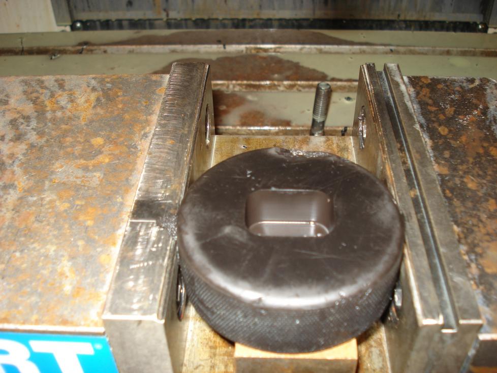

We use the late Porsche 944 aluminum jack for our Porsche 356's. They are light and compact yet lift high enough for real use. Here is something I do to make them a little more user friendly. I take a used (or new) rubber hockey puck and mill out a rectangle which allows it to be pressed onto the center nub of the jack giving a non-marring surface that is also wider and more stable. I have offered this service for our 356 club members free of charge as long as they supply the hockey puck and pay all the shipping. If anyone here is wanting this also for their Porsche 944 jack, I am extending this offer here as well. PM me for details. I am enclosing some pictures of the jack and hockey puck.

Great idea, thanks for the pictures !

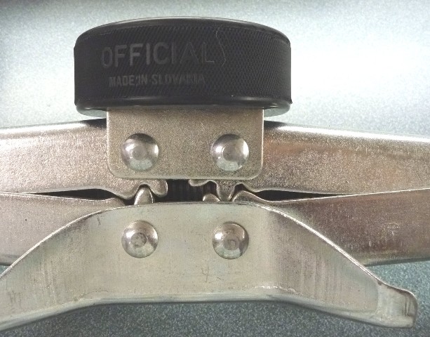

Here's the puck Jim (Healeyblue) machined for my Harbor Freight scissors jack - nice work!:
