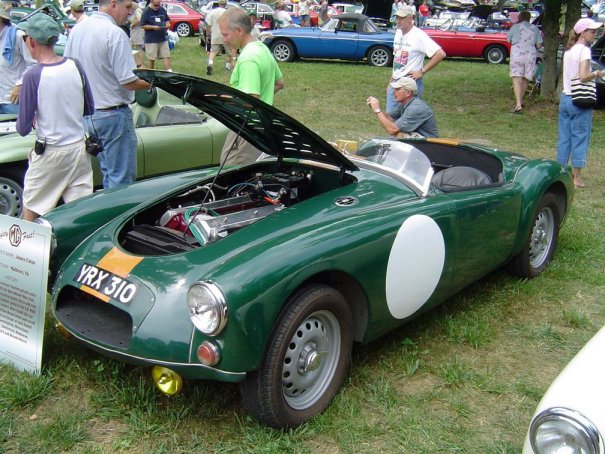

With that VIN number I suppose it could have also been a DeLuxe with a 1600 engine originally. That would have had the same chassis as the Twin Cam but with a pushrod engine installed. If so it would have the Dunlop solid center lock wheels, rear disc brakes and the correct front crossmember for a twin cam with the access holes. Still, if it was indeed a Twin cam the VIN number would have started with "Y" instead of the "G". A photo of the wheels would tell for sure if it's a DeLuxe or a standard MGA. Here's a photo of a Twin Cam to show you what both the engine and wheels would look like.
