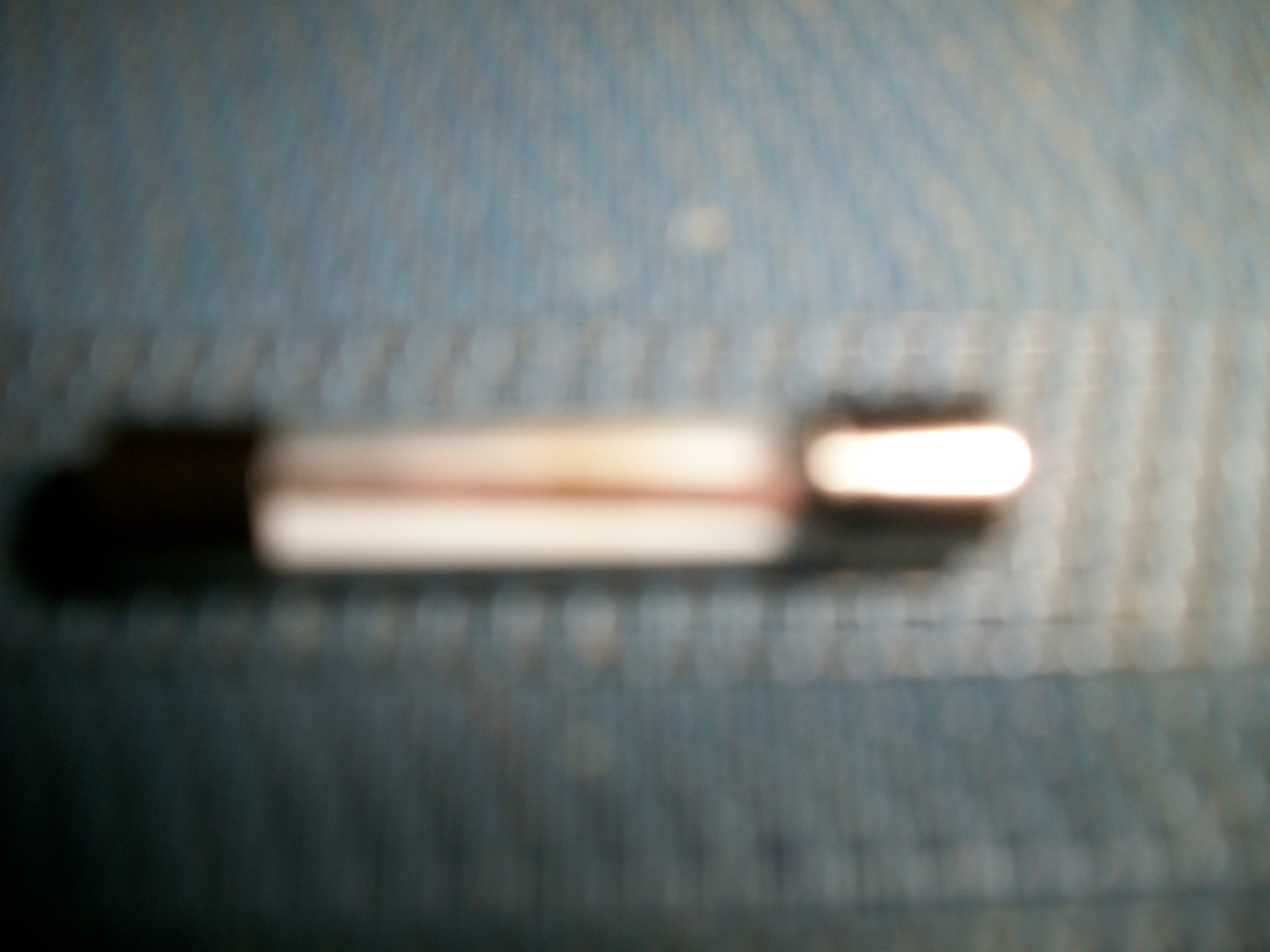

I recently went on a drive and the car went dead. I have an electric fuel pump. Turned the key on and could not here the usual hum the pump makes. Checked the fuse and it looked ok but no power to one side of the fuse! Installed a new fuse and I was back on the road. Why would the metai strip inside the "blown" fuse still look intact?

Good question...can you post a pic?

I wonder if the fuse could move just enough from one of its keepers to disconnect it so current could not get thru?
Platinum
Not unknown for the cap on a fuse to become disconnected from the inside strip. Ohm it and check. And as Bob notes, it could also be that the contact at one or the other of the "prongs" of the fuse holder become a bit corroded and lose contact. A piece of a "green" ScotchBrite pad in the glovebox can be valuable in that case. šŸ˜‰

The fuse I thought was blown passed the ohmmeter test so I think the issue is with the corroded prongs so I'll try the scotchbrite pad. The lower prong dosn't seem quite secure enough. I'm wondering if it just needs to be bent in a bit? Do you think it's possible for the fuse to get jolted outward just far enough to break the electrical current? Also is the 25AGC fuse equal to the stock 30 amp fuse?

Those old-fashioned cylindrical cartridge fuses are famous for that kind of failure. I've seen it many times, as they are used in all kinds of electronic test equipment from that era, and even up to today.

I had a similar looking blown fuse. The central metal strip looked good, but one of the end caps would spin around. Any ohm meter test was weak and intermittent. The best indicator was that none of the electrics fed by that fuse worked.

So very true. We had a close proximity lightning strike a couple weeks ago, neighbor's new whizz-bang digitally controlled refrigerator was knocked out. Two controller boards, one with the power supply. Two smaller glass tube fuses, they brought them over for me to ohm. Both blown... a trip to the hardware store and the fridge was back up and running.
