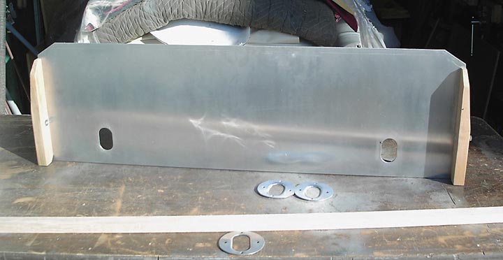

When I redid my rear seat, I replaced the board with aluminum. A door panel would probably need the mounting hardware reworked though.

If you have an aluminium rear panel on a BJ8, how will you achieve the large dimple on either side? The cardboard bends for it.

I'm not sure what dimple you mean. My rear seat was pretty much vinyl stretched over sawdust when I got it.

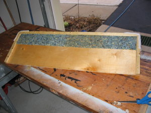

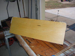

Or you can make a new one pretty easy;

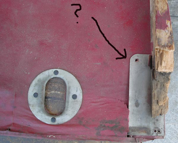

The metal reinforcing plate at each side is curved. The fiberboard takes the shape of the curve so there is a slight bulge visible if you look through the back window. I have some pictures I took upon dissasembly of my rear panel that I put into a pdf binder. Send me your email and I will send the binder.

Hi Ken,
Do you mean this piece? My originals were flat. I remade them in aluminum as well as the recess piece for the latch head. My addy is ahbj8@roadrunner.com or you could post them here.

Yes, that is the part. On my 65, both are bulged a bit. Perhaps the bulge was removed when the quantity of big screws from the wheel well to the vertical wood sticks was reduced.
