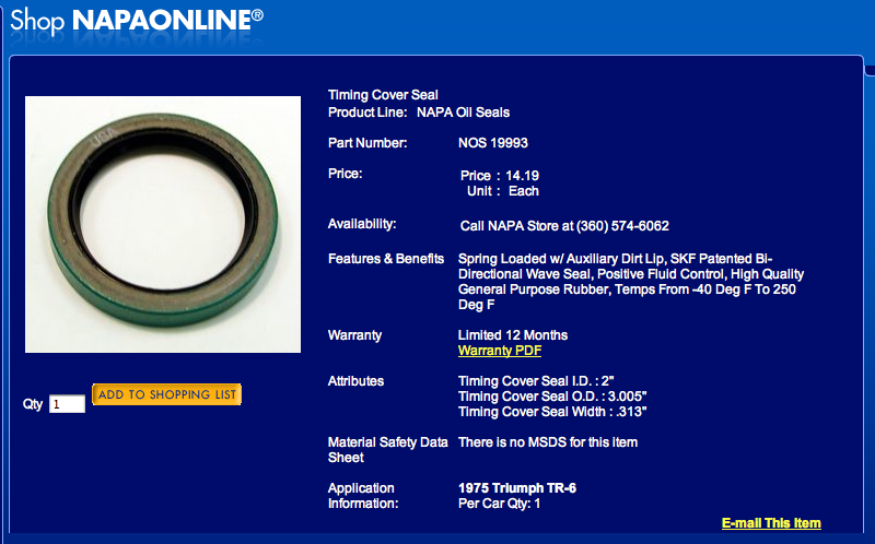

Darrell_Walker
I was able to look it up with Napa:

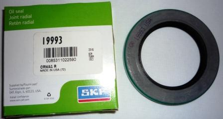

I just did mine two weeks ago and the photo below is the seal I used. I also installed a new sleeve since my original had a groove in it.
Important: It is a royal PITA to get the timing cover back on because of the timing chain tensioner. I made a wire hook and pulled it out of the way in order to re-install the timing cover.... then you have to fish out the wire hook :wall:
Edit: The seal was about $7 locally from an industrial supply company
Edit: I just looked at the part number in Darrell's post above... it's the same part number.

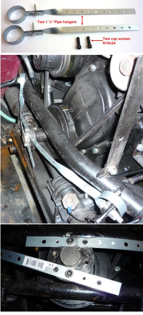

One more heads up... you will have to keep the crank from turning to loosen the crank bolt.
Here's what I did....
simpson
Gliderman8 said:
I put a new key in when I rebuilt the engine so there was no need to remove it just to replace the seal.
That's pretty ingenious rig to hold the crank.
But, I thought the woodruff key had to be off the crank in order not to foul up the seal when putting the timing cover back on. I guess its large enough to clear the key. Must be thinking about something else I have to put back on that I need the key out for.

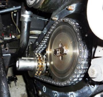

I just went into the garage and removed the timing cover to take this photo for you... hope it helps :jester:
TR3driver
Great Pumpkin - R.I.P
Doesn't even the oil slinger have a notch in it, so it can slip over the key? I'm pretty sure the TR3 version does.
simpson
Elliot, Thank you for doing that!!! I remember now, I was just thinking I might need to shim the new crank sprocket when I go to reassemble the engine that is undergoing a rebuild if it does not align (in terms of being on the same plane) with the new cam sprocket. the key would have to come out for the shims. I have my oil thrower off, and it has a key slot so that must not be the reason. I took it all apart in Dec. and have run into a slow (busy) machine shop, so I have forgotten some stuff.
Gliderman8
You are probably right Randall... honestly I was going from memory which can be dangerous!
In replacing the front oil seal I didn't have to remove it; I'll check my diagram but as I said you are probably correct in that it is keyed.
edit: I just re-read simpson's post and he writes <span style="font-style: italic">"I have my oil thrower off, and it has a key slot...."</span>
