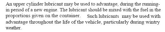

BillyB62 said:
Also, what is the purpose of using MMO each tankful? I use it in my dashpot, but I'm not sure I've heard of anyone using it in their tank.
Check your owner's manual, it is suggested in there.
I am also running an upper cylinder lubricant, but instead of MMO, I use synthetic 2-cycle oil (rated TC-W3). In theory, it will extend the life of the piston rings and cylinder walls. I don't know if that is true or not, but the theory is that E10 (which is all you can buy here) has more of a tendency to wash away the oil film on cold starts and potentially lead to rapid ring wear. One of our local club members had his TR4 engine "wear out" (huge ring gaps) in something like 10,000 miles after being rebuilt; and I've heard of the same thing happening to other old engines.
Maybe it's all "snake oil" and paranoia, but it seemed to me that the blowby on my 56 TR3 was getting worse over time before I started adding the oil; and now it seems to be very slowly improving just a bit. Oil consumption is also down somewhat. I can't prove it is due to the oil in the fuel, but the idle rpm also crept up and had to be turned back down. At any rate, I intend to continue the experiment until I'm ready to rebuild the engine.

BillyB62
Once again, thanks to all that responded. I did read that but for some reason took it as just during the break in period of the engine, something that has long since been done. Thanks to my trusted BCF adviser's, I'll be adding MMO to my tank fulls from now on.
