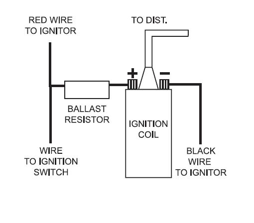

From the Pertronix box:
That is kind of misleading, though. It can be used with a 1.5 ohm coil of course; but to use a 1.5 ohm coil on a 4 or 6 cylinder engine, you also need a ballast resistance in the circuit.

tdskip said:
There are two versions of the Lucas coil if memory serves.
That is true, but the 3 ohm version is the "good" one. If you use the 1.5 ohm, then you need a ballast resistor in series with the coil (but not in the power lead to the Pertronix).
poolboy
The TR6 ballast resistor wire supplies over 8 volts to the coil. It's enough voltage to satisfy the 8 volt minimun for the Pertronix Ignitor switch to work properly.
If you have a ballasted ignition that supplies less than 8 volts to the coil, you will need to pick up a 12 volt feed from the ignition switch.
Other than that the Pertronix doesn't care. If the coil was compatible with the points and condensor and the rest of the ignition system before the conversion,it'll be happy with the Pertronix and vice versa.
