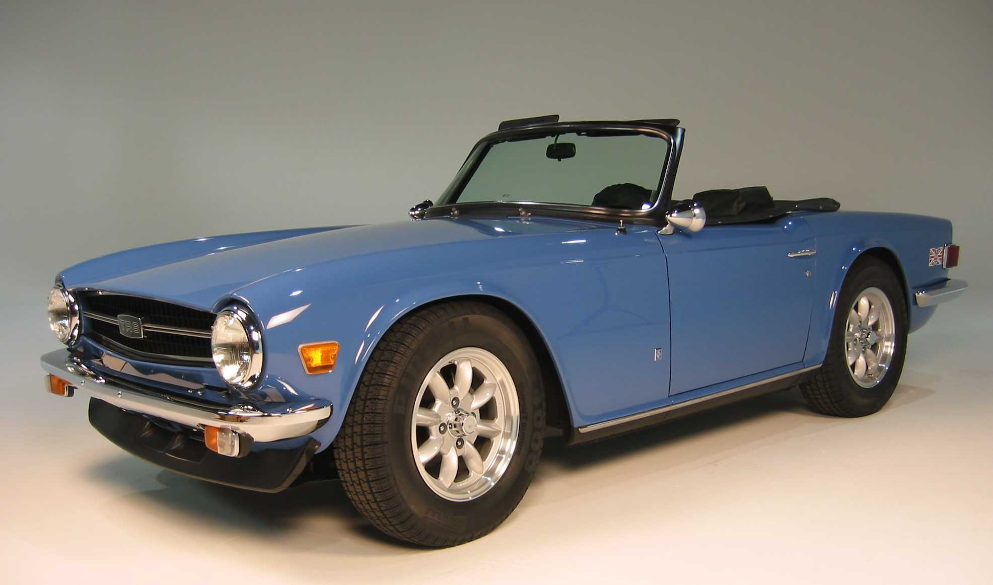

I have stock wheels and just replaced my Redlines with Goodyear Assurance 205/70/R15 tires. The ride and handling are great, in fact so much better than with the redlines that it was like driving a new car.
Speedometer is off 1 mph (fast) at 60mph and the car is so much smoother on the highway.
I don't have a better pic of tires than this, but you get the idea.
