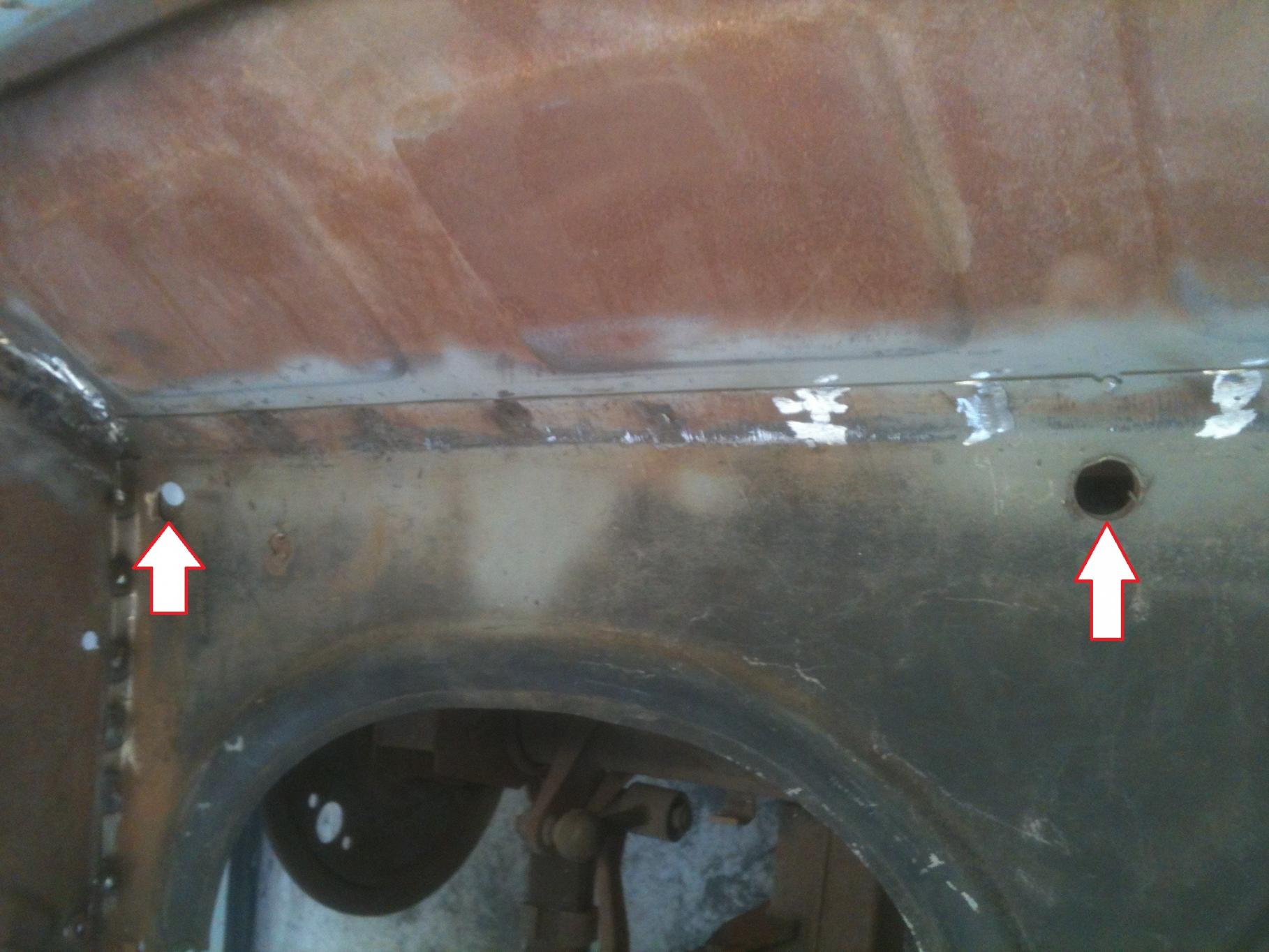

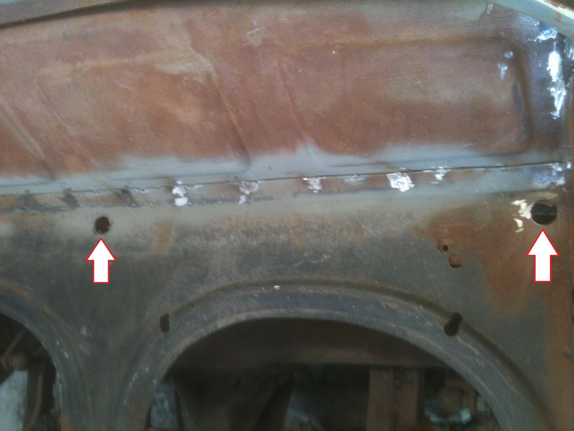

Hi,
Can anyone tell me what the holes as marked in the pictures are for?
Or are they not Original?
There are in total 3 of these holes.
Regards,
Henry
Keoke
It looks like those are the holes that the seat pan studs go through. Nuts and washers are installed underneath to secure them in place ??
GregW
Platinum
Hi Henry,
Those three holes are for the drain channel hoses. There are five hoses total for the channel.
Keoke
Yeah you are right I could not get those pics clear.
GregW
Platinum
No worries sir. One thing I'm not clear on, was the carpet laid over top(front) of the tubes to hide them?
RAC68
I think we are getting too familiar with our Healeys. Given a rusted nut, I bet there are those that could tell what it held along with the year, model, and color of the car.
Good job guys,
Ray (64BJ8P1)
H
HealeyVanZet
thank you all for your reactions. Does anyone have an example how it has to look if it's finished, in fact the Original situation?
thanks,
Henry
