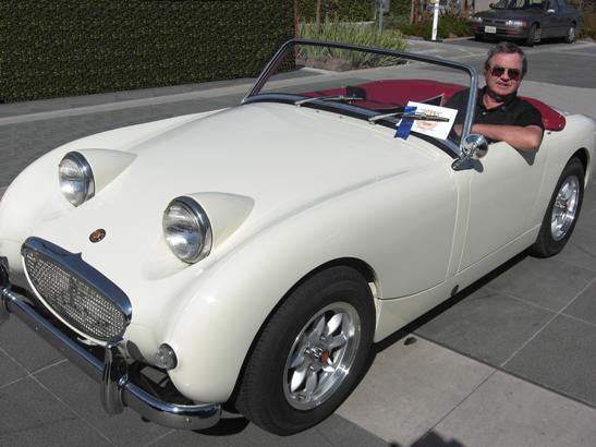

From what I hear, you want to do everything necessary to have a fantastic BE with all the right upgrades. Your build is very similar to mine......old English white with a red interior.....1275.....Datsun 5-speed....disc brakes.....upgrades electrical....etc. I say go all in, strip the body...send it out for repair and paint....meanwhile....start collecting parts and figuring out all the vendor and parts to use. I would use Gerard's 5-speed conversion....brake and gas lines from Fed Hill.....VTO wheels (if you want to upgrade) from Hap....engine stuff APT.....AH Spares has great quality stuff....most difficult parts to find....green turn signal light...windshield washer pump....windshield washer bottle...Cheers...have fun! Scott in CA

From what I hear, you want to do everything necessary to have a fantastic BE with all the right upgrades. Your build is very similar to mine.... I say go all in, strip the body...send it out for repair and paint....meanwhile....start collecting parts and figuring out all the vendor and parts to use.
Very similar indeed! I'm certainly not going down a very unique path, but there is a reason that setup is popular -- I'll be very excited when I'm on the other side and driving.
