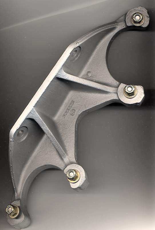

Does anyone know where I can get a TR250 rear differential cover bracket? Seems there is this bracket that bolts up to the actual diff. cover. The Moss cat. shows it as having four holes and appears to use same/similar rubber mounts as the TR6. The Moss cat. also lists it as no longer available. I'd be VERY happy with a used one... Anyone?

like this? I sold this one on ebay in 2004 and have only seen one other since.

It would probably be easier to just get a replacement TR6 diff cover, which has that piece cast into it.

if you can't find the piece you are looking for it looks to be a relatively easy fabrication project, either in steel or aluminium?

I have one from a TR4a, which should be the same, but its not like the picture.
Mine has the crcular holes complete, so it supports the diff mount bushings; the one in the picture looks like it has been cut away for some reason.

It's true that the TR4A mount would bolt up to the TR250 diff, but they use completely different bushings for mounting - the TR250 and TR6 uses a bushing with a metal plate imbedded which bolt to the mount while the TR4A uses cupped bushings like the front diff mounts
