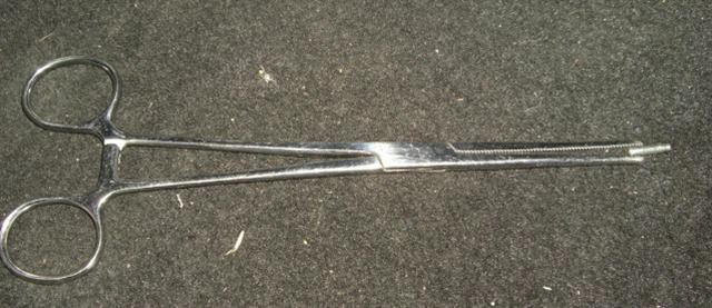

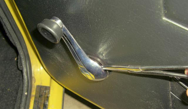

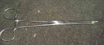

Not too difficult with a pair of locking forceps..... scroll to the end of this page on my site and you'll see the pictures of the tool in use. One caveat.... I never put the springs in as I don't see any difference with or without them

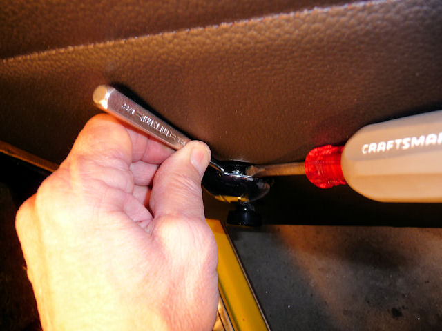

I use a screw driver to spread it apart and a punch to tap it all the way in
