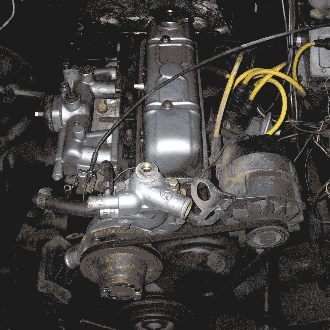

Hello All,
I am pulling the head off my midget this week to have it resurfaced and ported out. It is a 1500 Triumph that fits my 78 midget.
I have Two questions for you guys.
1) What would be the largest intake valve I can get for this head.
2) Does anyone know a magic number (depth) for shaving this head and getting a fair amount of compression without turning this motor into a grenade.
Thanks All
