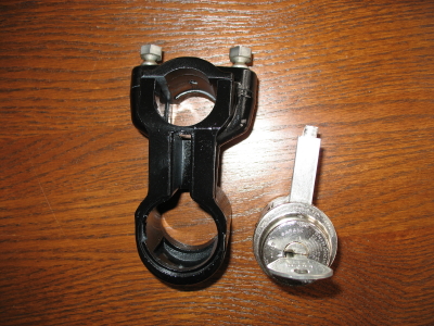

Thanks to all who took the time to reply, greatly appreciated. Now, do you think it'll fit a Austin Healey? The steering column, on which the lock surrounds, is 1 5/16" in diameter, and yes it does fit underneath the steering wheel. I'll take a photo and add it here:

TRopic6
Johnny,
I measured the ignition and steering column lock assy I bought to replace the balky one in my TR6. Looks a lot like yours but I got 1 1/4" for diameter.
Jeff

Thanks Jeff, that might work because the top part has a screw through it that contacts the column for adjusting. Could you please measure the part that goes up in the steering shaft, the AH one I have measures 7/16" by 8/32".

TRopic6
Aloha Johnny,
The bar that goes up into the steering shaft is 5/16" wide and about 1/2" long (it has a slightly rounded shape on the front & rear ends). It sticks up about 7/32". I tried to add some photos but don't seem to be able to attach tnem right now - I'll post a PM.
TRF has ones that are brand new for about that. I got mine for much less on eBay but maybe I was just lucky.
