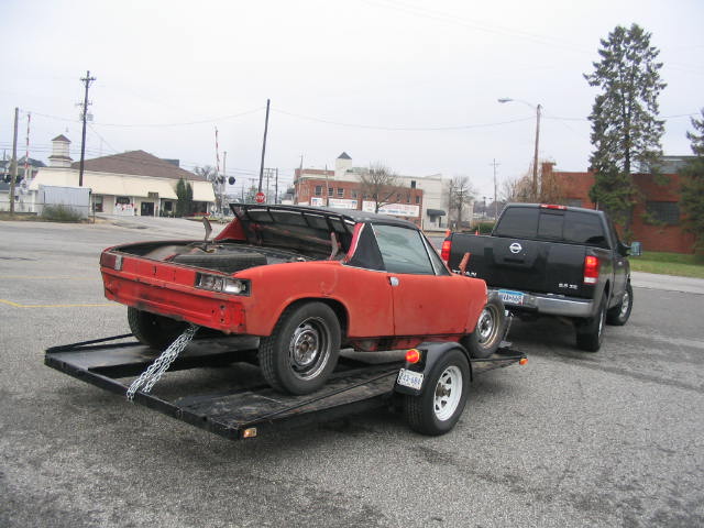

Here's mine. Very light, open center.

I probably say, I got alteast 20,000+ miles towing cars in open and enclosed trailers. Here's my advice on tie downs, forget what you find locally in most areas, they are a joke.
You want some 3" wide rachet style with safety closed hooks on the end and while you at get about 4 axle straps they come in handy, Racer Wholsale is a good place to find these. Towing with open hooks is a invitation for diaster. Oh and if you have good tie downs, you can tow in neutral and not beat the crap out of your tranny, for me with $5K racing trannys, that's pretty important /ubbthreads/images/graemlins/smile.gif

Shealey, that's a nice looking little trailer. I'm thinking of trying to get something similar made/found next year.

Shealey, I'll have one as well pls.
