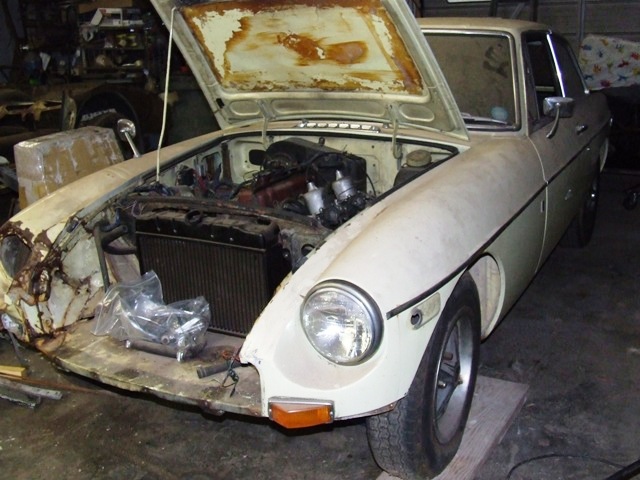

I just bought a '70 GT project car. I've owned several MGB Roadsters over the years but a GT is a new thing to me. Are the doors the same (other than the vent windows)? The door panels are shot and I'm wondering if I can use door panels from a roadster.
tony barnhill
Great Pumpkin - R.I.P
Doors are the same...there's a little chrome piece that's on the end of the GT door that's not on the roadster door - but the same doors...the roadster doors you have will work on the GT....you'll just have to use the GT vent windows, side window & window trim.
