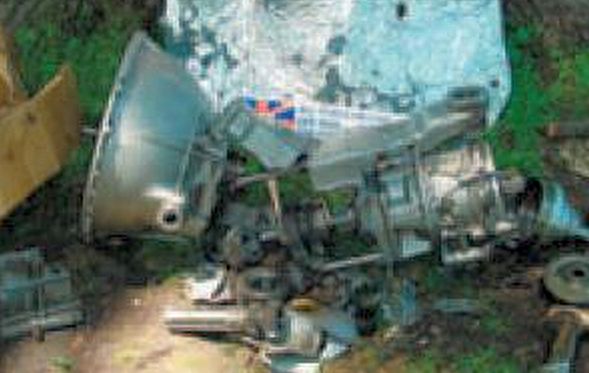

The tooth next to the broken tooth is going to be taking a lot more load, right at the tip where it is thinnest. Will probably work for awhile, but eventually it will let go as well. Which won't leave you much worse off than now, unless the broken tooth just happens to get jammed between the gears instead of just falling harmlessly to the bottom. It's thought that something similar happened to this gearbox:

Randall, that is a scary picture and I understand how catastrophic a floating tooth could be. That's why I wanted to remove the bit I thought was in there. The neighbor would be more strained and (more) failure is probable.
