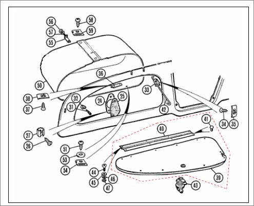

This may help
PeterK
In addition to the std mounting, I added an aluminum bar underneath the glove box running side to side, finding existing holes to tie in to. I found that a little weight in the cubby would pull the fiber-box down a little and my method provides the additional support required to keep it in place. And it doesn't show unless your head is under the dash.
