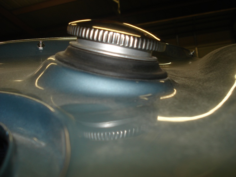

I have now destroyed 3 rubber gaskets that fit the filler tube to the body. If I get the body in the grove, the filler cap sits up very high with the tube flange on top and too low with the flange on the bottom. Where do I get one that fits proper so it appears as in the A/M Restoration book? I have been getting them from Moss and cutting bottom off.

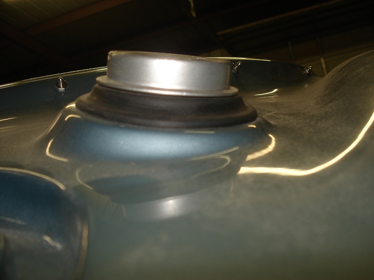

The problem is the filler tube flange. I mounted with the flange above the gasket, the cap sits about an inch higher than the gasket. If the flange is mounted below the gasket the filler tube does not reach the top of the gasket and the cap will not fit on. It has been suggested that I grind off the flange.

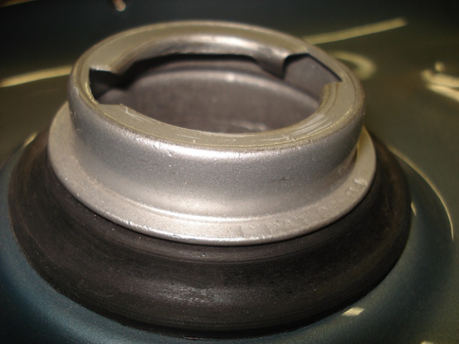

The BN4 I am restoring has the flange resting right on top of the grommet and it doesnt seem to be sticking up too high. The flange is actually a swagged section of the pipe. If you tried to remove it you would be making the tube a two piece tube.

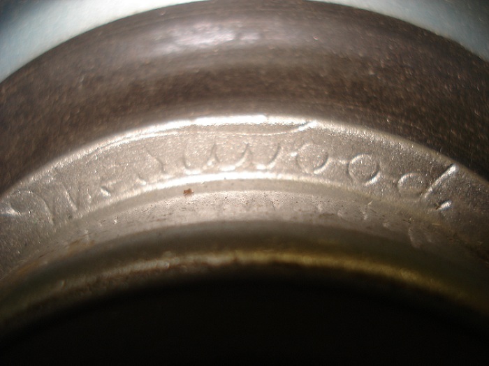

Heres a follow up with pics from the car I am restoring. The tube is stamped "Westwood" and a pat. number on the flange. from the top of the flange to the top of the tube where the gas cap will seat is .470 inches high. I am sure this is the original tube to this car. In the one picture you can see inside the tube and can see that the flange is pressed or "swagged" into the tube and is not removable. Hope this helps. Of course I suppose there are different tubes and manufacturers used throughout the production runs. This car is an early longbridge car so it very well may differ from all others.
