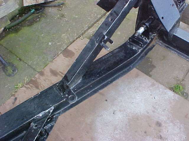

In the TR3A (TS comm numbers) it was attached to the end of the metal fuel terminating in the engine compartment, left hand side of the car near the fuel pump. I assume that it would be similar on the TR3B. There is a metal bracket with hole in it attached to the frame brace running chassis main frame rail and the front suspension tower. The fuel tap mounts in that hole and is secured to it with a nut screwed up on the base of the tap. The connection between the fuel tap and the fuel pump is a flexible fuel hose.

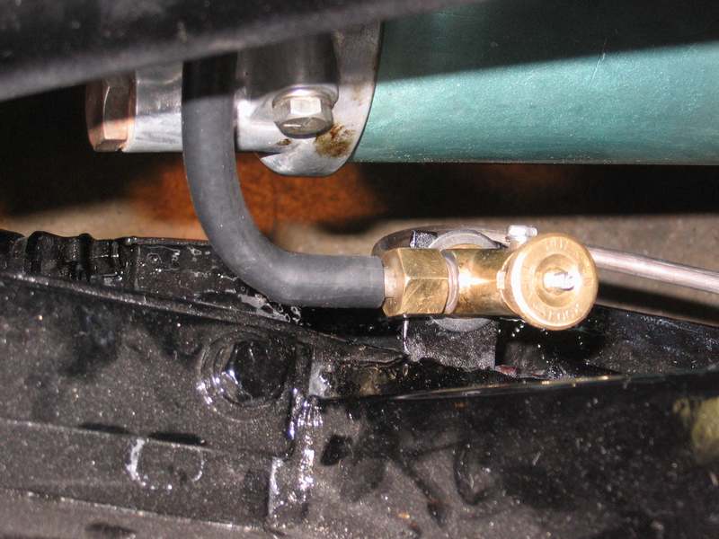

The shut-off valve goes on this bracket. It is held from below by a big nut on the inlet where the fuel line come from the rear of the TR and turns upwards to the bottom of the valve.

Don Elliott said:
This is what it looks like from above.
Don, I trust that this shot was taken BEFORE you put the hose clamps on......

TR3driver said:
ISTR the factory didn't use a clamp on that joint. It's the suction side of the pump, so not really necessary as long as the hose fit snugly over the tube.
The factory didn't even use clamps on the pressure side, where the fuel hoses slide onto tubes at the carbs (but I definitely recommend adding them there).
ANY junction that is unclamped in a fuel system is inadvisable and would fail any tech inspection I'm running! I've seen those hoses get soft and squishy and start leaking past the spigot that they are stuck onto.
