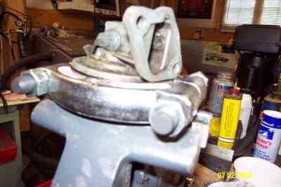

I inserted a 3/8" bolt through the hole in the thin wall cup and inserted a matching hex nut inside the pump body, threading them together. I inverted the pump body and clamped the head of the 3/8" hex bolt in my vise. Then I used a clamshell clamp used for pressing bearing off and lightly and evenly wedged it under the head of the hex bolt. These clamshell clamps are used when removing pressed-in bearings to add the pressure around the bearing holder instead of prying around each edge. It's like having a full circumference of screwdrivers all prying at the same time and at the same intensity. So after the clamshell was lightly set, I simply grabbed it from each side and pulled upwards. Voila. Done.

Ok this one shows the pump body. The 3/8" bolt head is clamped in the vise and the body is resting on the clamshell bearing separator.

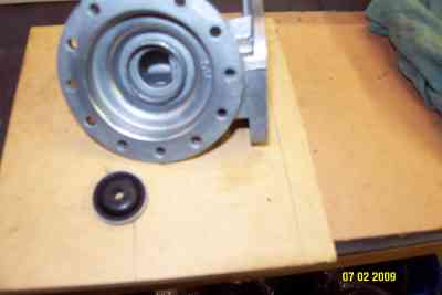

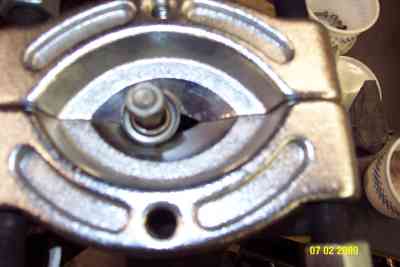

This one show the completed removal of the seal retainer cup after the pump body is lifted off.

The new seal sits inside of the cup and then pressed in with my fingers. I thought I would need to tap it with a block but just pressed in.
This is from my garage camera so sorry for the blurrrrr.
