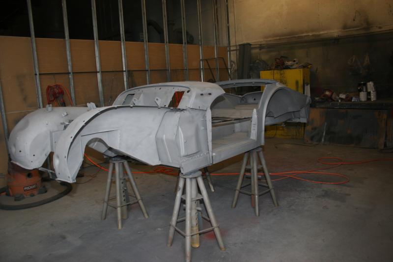

I had my tub and body parts sand blasted at a specialty automotive sandblasting shop. They epoxy primed most of the parts before I took them home. Was not cheap, but totally worth it. Soda blasting is more gentle on the parts, but a good sand blaster can get your parts cleaned up in a jiffy and is probably a little less expensive. No issues with panel warping or heat from the blasting operation.
