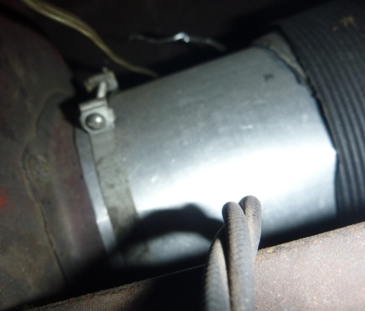

steveg
I made a slightly tapered extension from household aluminum flashing which clamps onto the stub. It's about 6" long. The fresh air hose is forced onto the taper.
Not shown is a pop rivet under the hose which keeps the OD of the front end at less than the ID of the hose.
This doesn't look stock, but then you can't really see it.

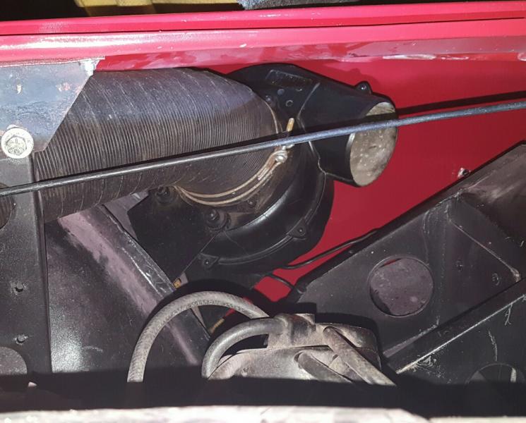

donaldvf
I have been putting my 1963 BJ7 back together after a frame up restoration. The body shop had full body on and mostly together before I came to the fresh air blower hose. I have owned this car for almost 50 years and have never been able to get an original hose on the blower. I did remind the body man to put the drivers side fresh air hose on but alas, I forgot about the blower. I tried a few things and after finding this thread was mostly disappointed. I finally put the hose on a 4 inch sleeve I had for a spare blower, clamped it down and bent and deformed it into a reasonable angle. I unclamped it and took it to my vise. I clamped an aluminum baseball bat in the vise and used a rubber mallet to pound the intake hose end thin, thus slightly expanding the end, essentially swagging the end to enlarge it. Then the trick which allowed me to put this together in less than ten minutes. I unscrewed the blower motor and while holding it in the fender recess, slid the hose on and clamped the crap out of it with my original 54 year old clamp. When I was confident the hose would not come loose, I pushed the motor close to its bolt-in position and started the two lower screws. After pulling the blower into position with the two lower bolts, I pushed/pulled the motor into position so I could start the two upper screws. It was easier to attach the hose if the motor was loose and able to adjust to the hose position. Forcing the motor into its proper place was a lot easier than the other way around. Hopefully this is the last tricky maneuver I need to pull off. The grillle is in, the carb linkage is attached and the rest should fall together.Heater.jpg
