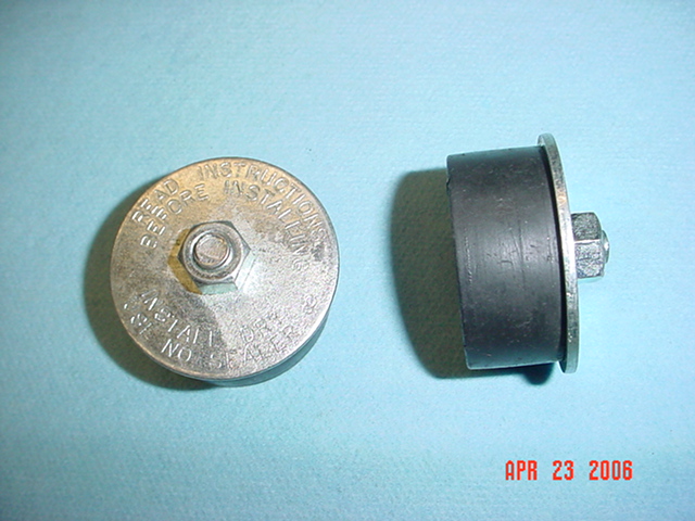

Actually, the expanding rubber "temporary" plugs have been known to hold for years & don't have to be driven in. I would certainly trust this plug more than trying to seal the leaking plug. See the attached pic.
Most plugs that leak show a small rusted through pin hole. It wouldn't hurt to carry spare rubber plugs of the appropriate size, just in case another one happens to let go.

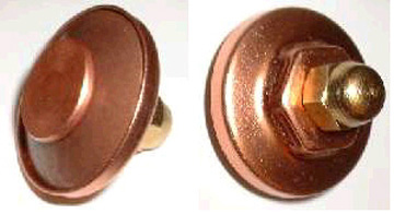

If you don't like the idea of rubber plugs, another type of all metal core plug that is made by Dorman, can be tightened into place with a wrench. These have been known to last for many years. See attached pic.

Re: Popped out the old one
YepDave, and they make one with a bronze top and bottom that should follow you to the grave.---Keoke- /ubbthreads/images/graemlins/grin.gif
