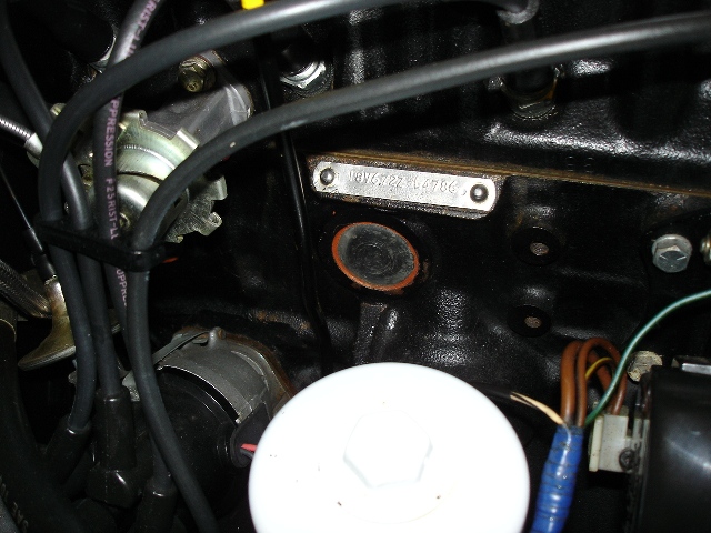

Nonsense. Properly installed freeze/welch plugs never weep. The seat needs to be cleaned up with a scraper to make sure they seal. The factory installed them dry, but I always use a thin smear of RTV. You then whack them in the center with a 3/4" socket to seat them. They should never come out. See attached for how they should be installed.
The really bad news: the engine needs to come out to replace the rear one, if you dont want to risk it.
I'd return to the shop and raise, well, you know...
