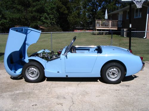

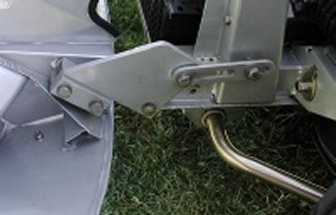

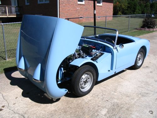

I like it, makes it much easier to get to the engine during the tune phase of the rebuild but it should come in handy later on as well.
What do you guys think?

I have the same type hinges on mine, and my bonnet is so flimsy that it rubs when closing unless I hold it near the middle.
If everything else on the car is original, I might be tempted to put the bonnet original.
GreenHornet
The only problem with the tilt front is you can't run a front bumper and installing my radiator was a little like doing the limbo. My car has one and I couldn't see myself changing it back. Mine has the "Gravity" latch system. The works leather ones are kinda neat but you have to drill holes for them.

With this hinge you can run a bumper. Says so right in the instructions! I haven't tried it yet but it looks like it would work.
This car had the metal latched originally but I repaired the holes during the body work. An latch that I install will be all internal.

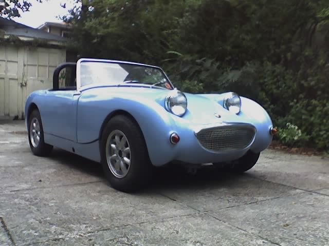

Your car looks so much like mine, that everytime I see it I do a double take.
I will post a picture when I get home.
Pat

I tend towards the original camp, though it's definitely a personal-choice sort of thing. That setup looks nice and clean -- a couple leather buckles on the outside would look nice...

I think I like that, will be much easer to work on engine and to keep things clean.

My '60 Bugeye race car that I sold this summer ahd a forward tilt bonnet; I liked it. Enough so that I took a LOT of photos and measurements of the tilt brackets and plan to modify them somewhat and include a tilt bonnet on my current project, a '62 Sprite.
Unlike the bugeye, the Sprite has separate wings (fenders), bonnet, and front cowl/grille surround that will all have to come together as a single unit. I won't be running bumpers so that's not a worry.
I've not seen a Spridget with a metal tilt front end, only the fiberglass ones, and I want to do it out of the original metal components.

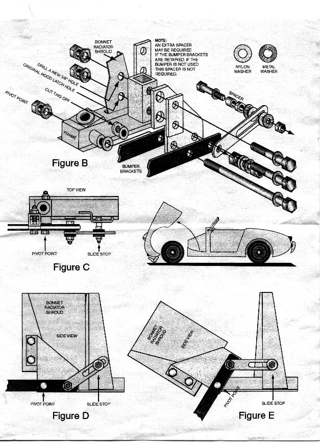

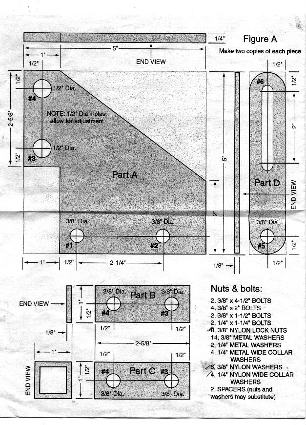

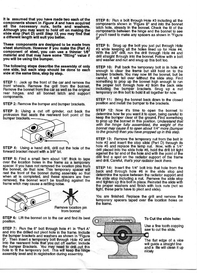

I got the plans for these hinges from Gerards Garage. I don't think he has the tech section back up yet but I can probably find the file if anyone wants it.
I like these hinges because they have a built in stop/guide.

Does this look familiar?
Pat

Oh Ben, don't put a bumper on it. Looks great as it is.

I have only worked on a single BE that a friend of mine owned while in the Marines, and I was always terrified that the bonnet would come down on top of us. I really like the tilt idea. I think it would help working on a Midget if one could be engineered. I always hated working in the engine room of of my ex's Midget.
