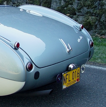

Steve,
As Greg mentioned using Bugeye rear bumpers is an option. I got my mounting bars from Cape International. This is one of those "to each his own" topics.

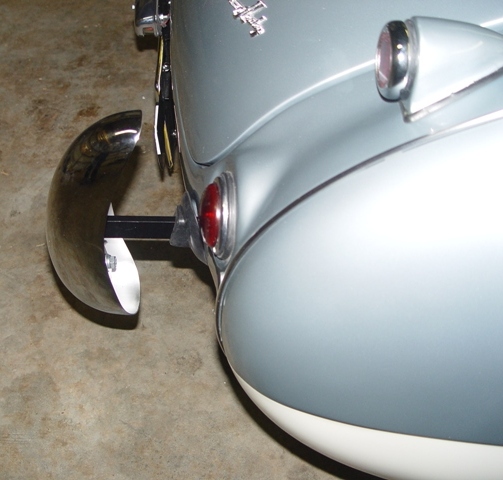

I tried the Bugeye bumperettes and mounting bars from Cape Intl on my BN2 and found them to be awkward-looking since they stand off too far, for my taste, from the rear shroud. See photo. I returned them.

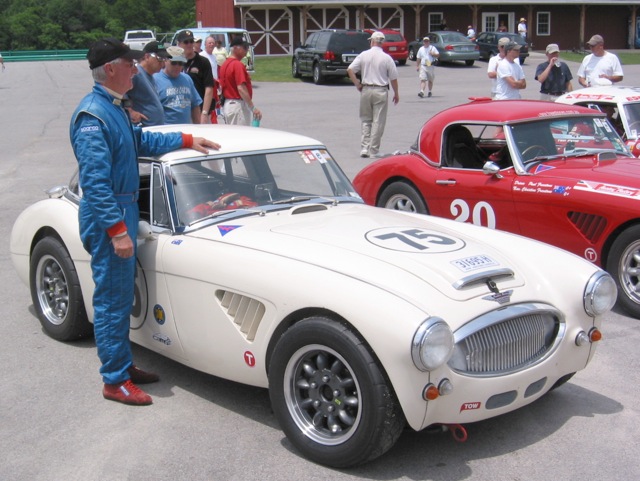

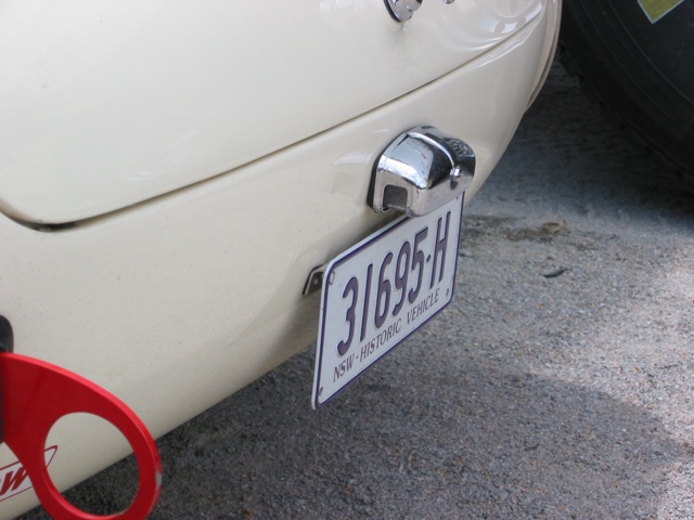

I have forgotten the chap's name, but this is one of your race cars from down under that was in the U.S. for the Challenge races a couple of years back. It looks like he just mounted the lamp directly to the rear shroud and then fabricated an aluminum bracket for the license plate. I think you could skip the fabrication and just use the BT7 bracket from one of the usual vendors. Hope this helps a little more.

Michael Oritt
Lin--
That's Peter Jackson in the foreground. The red car belongs to Paul Freestone.
