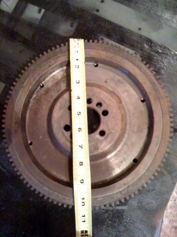

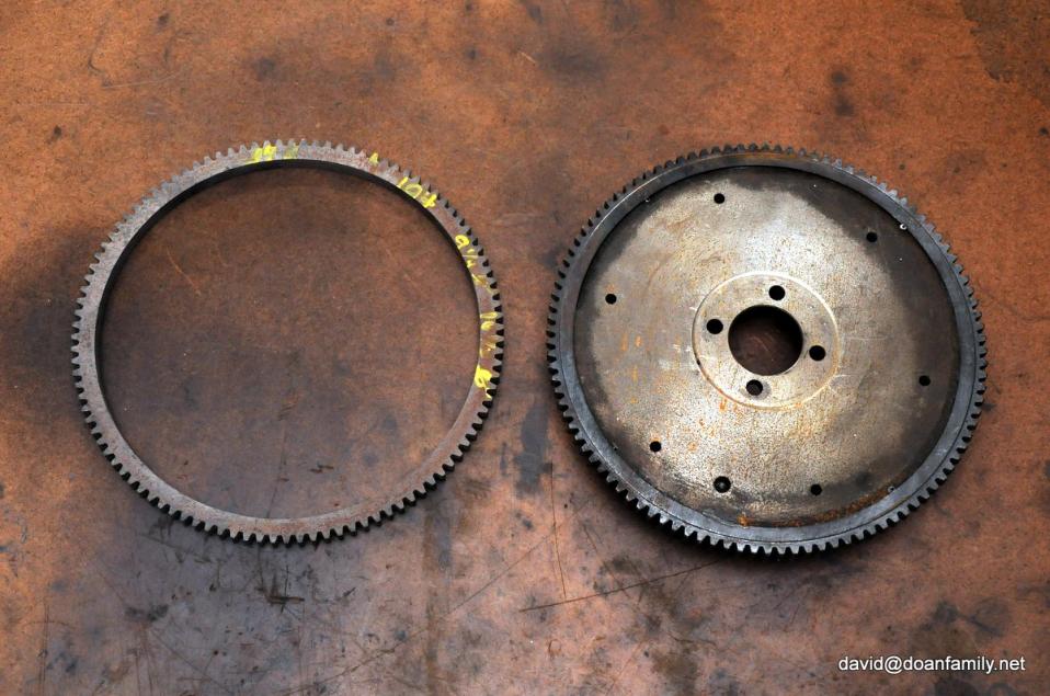

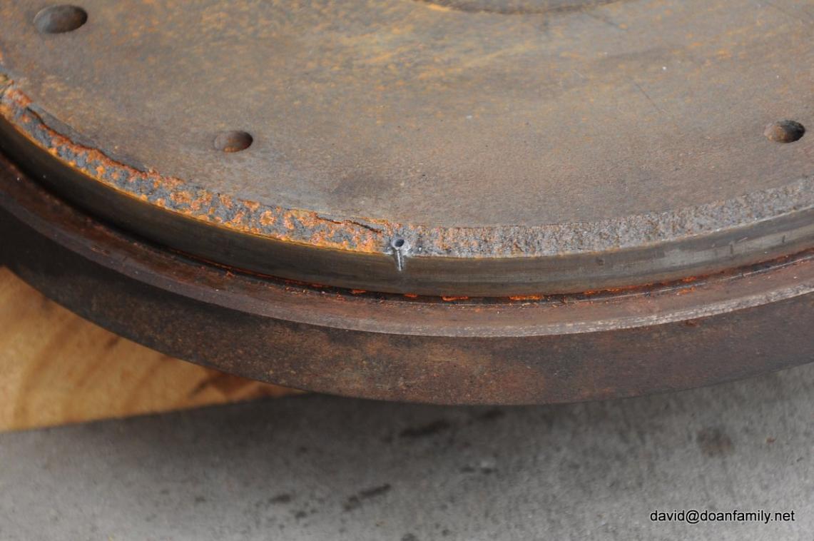

Got the old one off, new one is too big. The 948 needs a 9-1/8" inside diameter, I got a 9-1/4".
Anyone have a 9-1/8" ring gear? Anyone need a 9-1/4" ring gear?

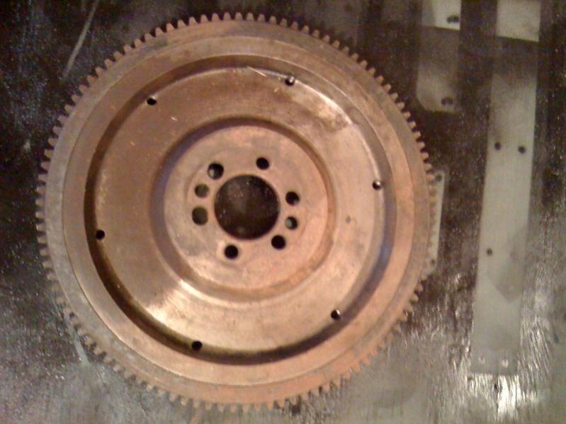

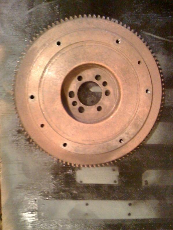

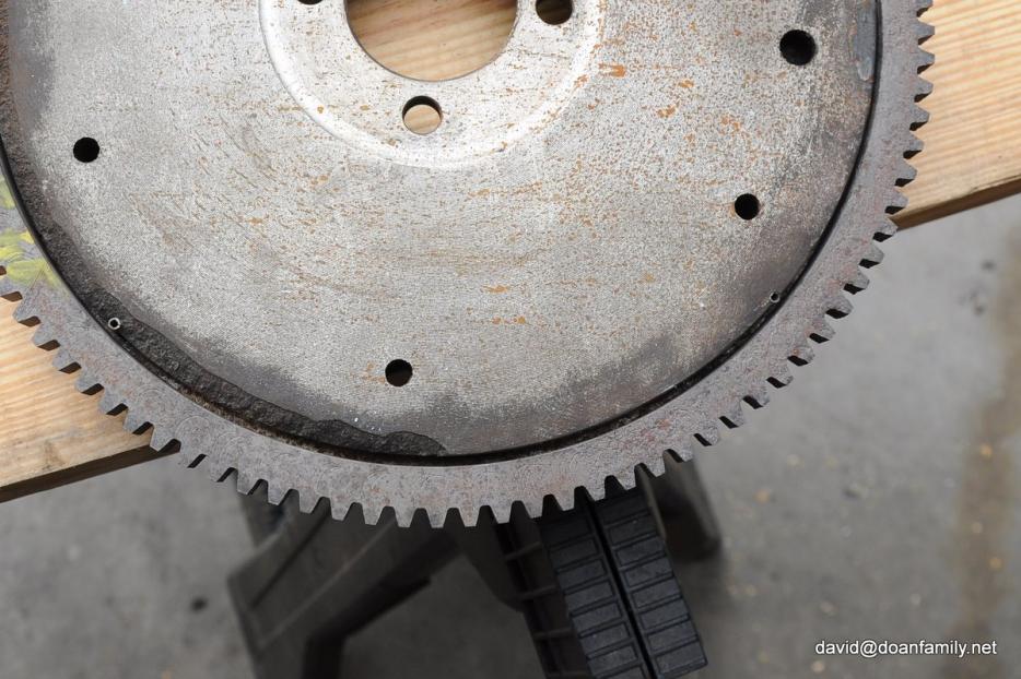

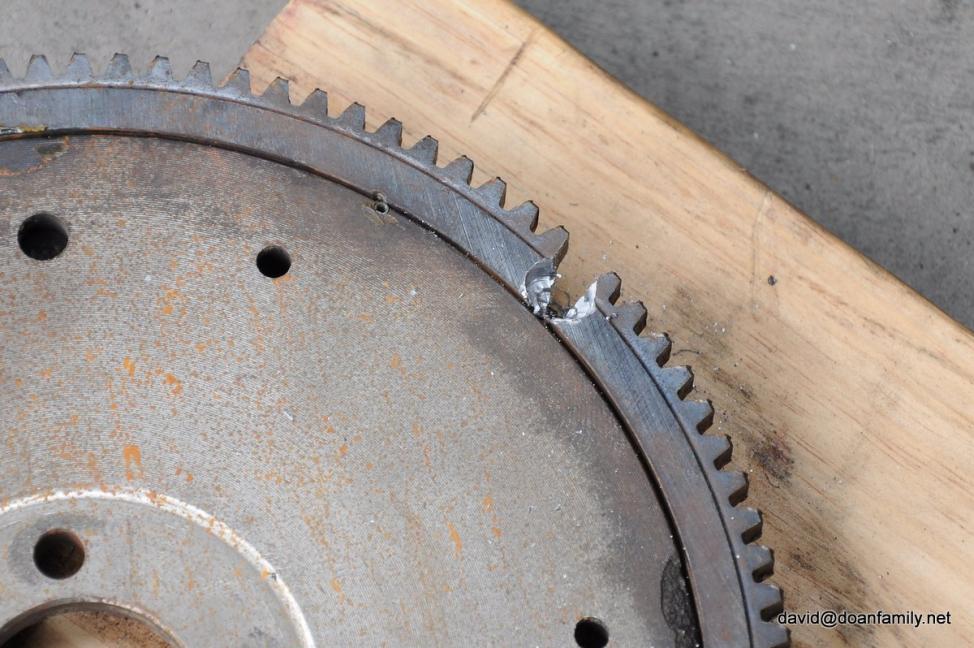

In the last pic you can see a spring pin that was driven in - I assume - to tighten the ring gear. There are 4 of these spaced evenly around, was this normal? Or should I scrap this flywheel?

that is one rough looking flywheel! I may have a good 948 flywheel in the shop and I'll post pictures in the morning. From what I remember the ring gear was ok, but the flywheel had been drilled to fit a 1275 crank. The 4 original bolt holes looked good iirc. Yours for shipping and it will fit in a medium flat rate box.

image.jpgimage.jpgimage.jpgDavid,
pictures aren't the best in the world, but I think you can see them ok.
Rut
Rut
David,
thats the flywheel that came off of my 948 and it fits the smaller diameter ring gear. I have a complete 948 in a box that's bored .060 over that I'm not going to use and this flywheel came with that engine.
Rut

1275’s flywheels are index through the dowel pins, can only go on one way for correct balance. 948’s are index with a ¼ mark on the outside edge that is supposed to be at 12 o’clock with engine setting at TDC for the correct balance. There is no way for a correct balance to be achieved unless crank and flywheel are balance together. It’s your call?
D
David_Doan
OK, Makes sense. So the re-builder for Rut's engine (assuming rebuilt since he said it was bored .60 over) could have balanced that flywheel to that crankshaft. but there's no way to balance/index that flywheel on my motor.
