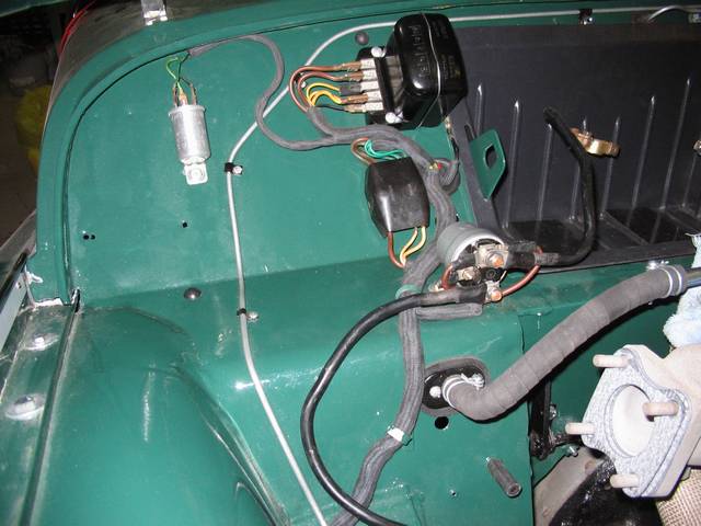

Note that it's different depending on whether you have a pre- or post-60K TR3A. Here's an old photo I saved from fleabay, showing what I believe to be correct for pre-60K LHD.
On post-60K cars, both the flasher and the control box were re-oriented.

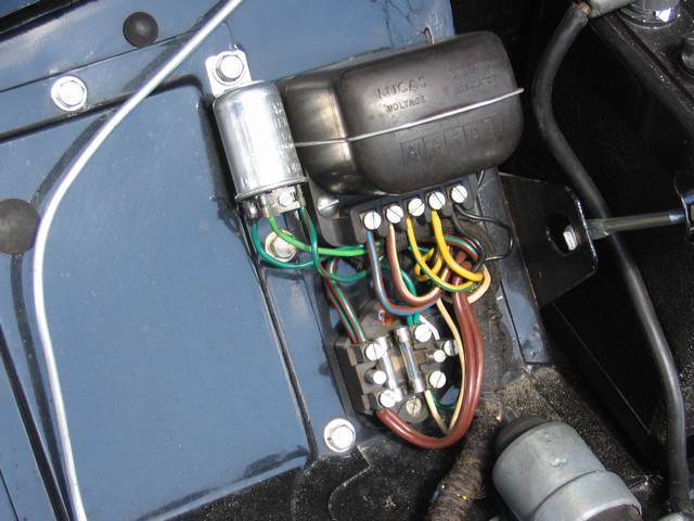

Randall - The photo of the red TR3A you show it a little off. Here is where it should be for a late TR3A (TS 81551 L).

You're right as always, Don. I just checked the TRA judging manual (should have checked it first) and it calls for vertical mount with connectors at the top.
DNK
Well that make sense. Just let the water drain down the connections
Don Elliott
Don - That way the water can seep right into the unit to do it's best job possible to corrode the innards. Luckily, my TR3A is an early one and the flicker relay is mounted like the one shown in Randall's green photo.

I'd say mount it pointing down unless your going to a judging.
