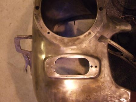

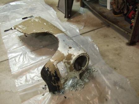

Earlier cars the turn signals are on the front, later cars with the side marker the turn signals migrate around the corner. The rest of the fender is the same. I cut off the lower front portion of a later fender and attached a 65 turn signal on to mine.
Mark
