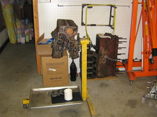

I'm forwarding this info from Richard Mayer. The trick is to mount the pivot center of the stand above the crankshaft center (with the engine in the upright position), so that the engine will rotate smoothly throughout 360 degrees. But, the correct distance between the pivot center and the crankshaft center depends on whether you have the head on the engine. BTY, these are a set of Richard's custom race
headers mock-up in the picture.
Dougie
