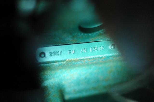

Mine has the following data;
Chassisnumber 40871
Enginenumber 29K-RU-H/15486
Builddate 1-2 March 1967
Despatch 4 April 1967

Here is mine;

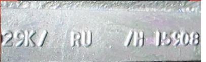

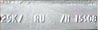

Hoghead, the car that originally had engine 29K/RU/H15908 was HBJ8L/41342, NOT 41341. I can show you exactly what the engine serial number plate for /H15908 looked like. I copied the photo from the eBay sale in February 2011. Another example of why the registry is a useful resource for BJ8 owners. The more owners who cooperate to contribute the details of their cars to the registry, the more valuable the registry can be to the current and future BJ8 community.
