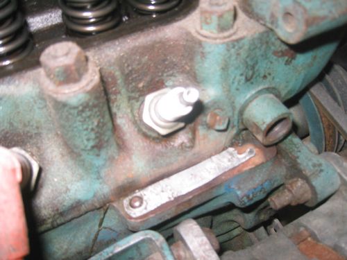

Can you get a new id tag for a 1275 with the number on it? The picture is kinda blurry but you get the idea. The current tag looks like someone beat on it with a wrench. I want to rebuild and paint the engine but don't want to put this crappy tag back on.
Also can you get the rivets that hold the tag on? If so, where?

Try Clark Spares:
Engine Tags
Let me know how they work out, I found them, but I haven't tried them!
spritenut
Clarke Spares makes new tags or pick up a number stamp kit for under $10 from Harbor Freight or some other cheap tool supply and stamp your own. Practice on a piece of aluminum flashing or even a soft board to get the feel of how hard to hit the stamp. Vic Brit sells the new blank ID tags.
Always use a HARD board under the new tag or you will curl it.
Ask me how I know /ubbthreads/images/graemlins/smile.gif

I had one made up by Clarke, very happy with it. He sells the rivets to attach it too.
fmichaels
I have also had engine tags done by clarke. nice work for about 24 bucks. includes rivets identical to original.
Gilly
I had to pay for the rivets. There are 2 different sizes. Nice guy to deal with.

Does he tell you what size rivets you needed or did you have to tell him? I have one broken off in the block & the other looks like it does not want to cooperate. I am going to have to try the drill/easyout method of removal.
dklawson
I wish I'd know there was a source in the U.S. for the reverse stamped tags. I paid a guy in the U.K. to remake mine.
FWIW, I bought stainless drive pins for my tags from McMaster-Carr. To remove the old ones I used a Dremel to cut a screwdriver slot in the pin head. A few gentle whacks on an impact driver easily backed the old pins out without damaging the old tag (which I have kept).
