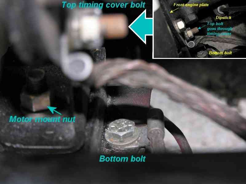

I did not find an engine ground strap on my 1959 TR3A when I took it apart, but I've read that one should be added, as with the TR4 and forward. Makes sense to me. Question is: where does it go? I don't have any examples around here to look at.
PeterK
Hope this helps.

Here's another shot, supplied by Don Elliott

Thanks for the pictures. I was thinking at the back of the engine, but I'll look at it tomorrow, to see where the "other end" goes on the chassis. It's probably logical when I physically look at it!
DNK
If concourse isn't a priority. Any spot on the motor to the chassis will work. Should prolly do a couple

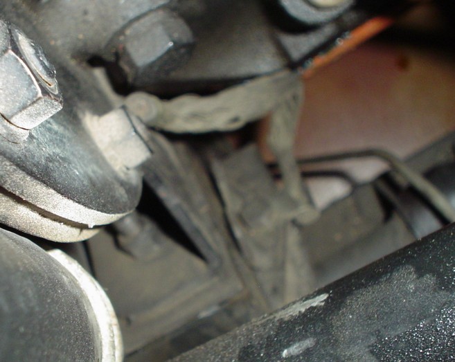

The chassis end goes on the bolt that also holds the motor mount to the frame.
(Sorry, I've lost track of who took this photo. If you recognize it, please let me know.)
After looking at it this morning, that's the conclusion I came to. It's the logical place, with the other end being on the time chain cover up front.
Thanks!
