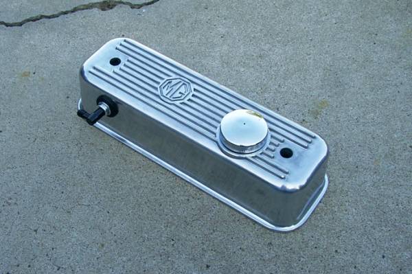

Bret: How's the fit of your valve cover, and did you have to tap the cover yourself for the breather line?
I wonder about the valve cover because mine, which is supposed to be stock but after seeing some of the stuff I have so far I wouldn't be suprised if it came for a wrong model year car, doesn't seem to fit quite right. The cover bumps against the thermostat housing up front and the fitting at the rear of the head for the water choke. I didn't notice this until I was putting it back on today and noticed the cover was teetering. In the end I had to bend the edge of the valve cover in the two areas to allow it to sit flat and centered like it should.
Bret
Yes I do have to fiddle with mine to make it work. The one I got from VB didn’t fit just right and I had to play with the gasket while tightened it down. But I don’t recall any clearance issues with the thermostat housing.
But for the breathing tube I actually have two alloy covers one actually came with the breathing tube the other I modified myself (see attached picture) using a hollowed out PCV valve and a grommet. I also inserted a flat 1/8th” washer into the hollowed out PCV valve to control the ventilation. To make it all work, I just used a hole saw to make hole the size of the grommet. Also you will need to plug the little hole in the oil filler cap, I used a self tapping screw with a dab of gasket sealer. Worked pretty good.

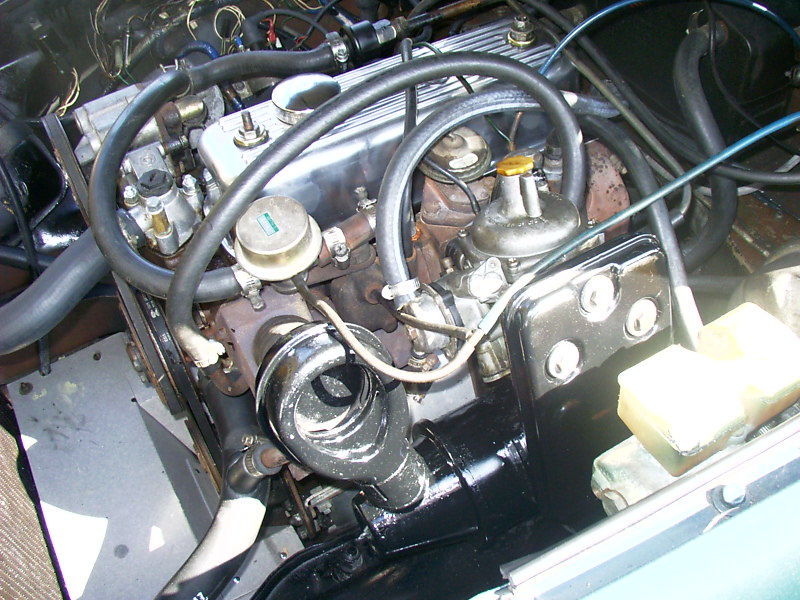

Looking at your photos - isn't that a stock stamped valve cover? I thought you where having problems wiht an Alloy head.
Anyway I checked mine out this afternoon and they look to have about the same clearance as yours do with maybe a fraction of an inch more by the choke fitting. If yours fits that tight - a quick & simple fix would be to run a file or use a grinder to shave the edge of the valve cover to give you some extra play.
Bret
Follow up: The attached pic isn't the best view but you can see how close the valve cover is to the thermostat cover.
