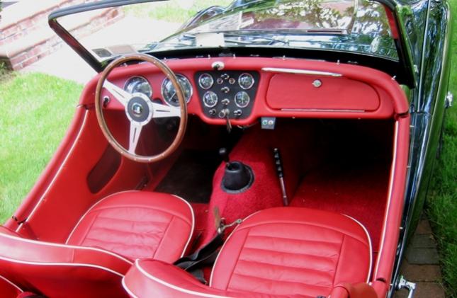

Are those leather seats? I would try some Lexol on them if they are without holes and re-stuff them. Some black shoe polish and I think you might be OK. I sent the Landrum TR3 pdf file to you via email.

Yes, They have leather centers, most treatments I tried did nothing, I may try to redye them black.
