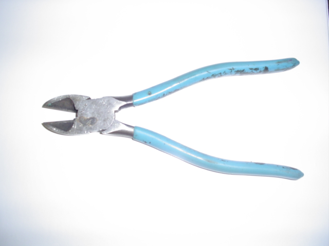

What are "plier dykes"?
Harry_Ward
Ian,
see attached,
Most refer to the curved one sided cutting pliers as dykes.
Harry
