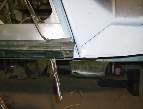

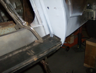

can anybody supply a picture showing the door rocker panel in relationship to the door hinge panel? I need to position this rockerand door to get the door shut panel installed thanks, Everything was eaten away by rust, and have no idea how it should look. Thanks, Bob (stinky60)

Thanks, to all of your responses, I do have the engine and transmissioin still in place. the tires are sitting on blocks, I,ve done all of my welding and fitting of my sheet metal pieces this way. The floor pans were in remarkable good shape. the inner sill on the driver side, had two bad sections, the very front and the very back.So rather than replacing the whole part Ijust cut out the bad parts,and replaced.. the,the drivers side, is done other than the rocker on the bottom,everything lines up good.The passenger side is another story,I've replaced the whole inner seal, but while doing this,taken measurement with each step I took,I,m up to the point of welding a section of the door shut panel, but need to position the rocker in the correct, place.Bottom line, the front of rocker onthe bottom has a gap about 1/2 inch the top mates okay with hinge panel,so I'm really concerned, if I'm going to haveto do some major cutting on the rocker,I bought the rockers from healey Surgeons a few years back.I will post some pics on saturday.
Thanks,John, those pics really put myself at ease,I always thought the rockers were butted up to the hinge panel, I have some work to do on the rockers. I do have some pics to attach. I'm not exactly sure how to post pictures here, never done it, I'm on the preview page but just can't get it how do you attach pictures? it's the little things that get me

Greg,you are right, John Loftus has been trying to help me out,It just didn'''''t dawn on me the files were too big,thanks to all for help. stinky(bob)here come da pictures .

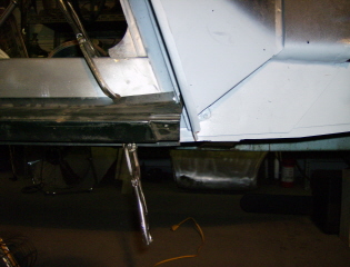

Bob, Glad to see you figured it out. If you want, you can post somewhat larger pictures. Here's the one you sent me resized to the dimensions Greg gives above.
BTW, it looks like the top surface of the rocker is angled too much. Should be closer to level.
John, thats a good size picture, I will do some picture resising, again thanks for gettin my brain in order.
As for the rocker I am going to fit the fenders and shrouds to get an exact position, it is at an angle. Stinky
