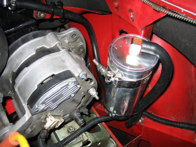

As long as we are talking about alternators, there are more choices in the world than just the NAPA/Delco that is usually recommended to us. For example, I installed a Leece-Neville (Prestolite) 70 amp alternator on my 100 (I chose it because it came with a split shiv which allowed me to retain the 5/8" fanbelt) and it has been bulletproof for about four years. It has an external regulator (see attached photo)--I have it hung on a CAPE mount but it would not be very difficult to fabricate one from scratch.

Michael, your point is well taken. I've hear and read about other alternators to use but to be honest haven't given them alot of attention because I use NAPA parts alot. But maybe I have been just lucky and shouldn't be so exclusive. I have already bought the brackets and the NAPA alernator. YOU DID MENTION something about the wideth of the belt. I was under the impression that I would use the same width belt as the original Healey belt, is that not the case? By the way I remember the discussion about your fuel pump failing. Do you believe it really was the alternator causing the problem? That could be alittle scary because how can you guard against transients coming out of an Alternator.
