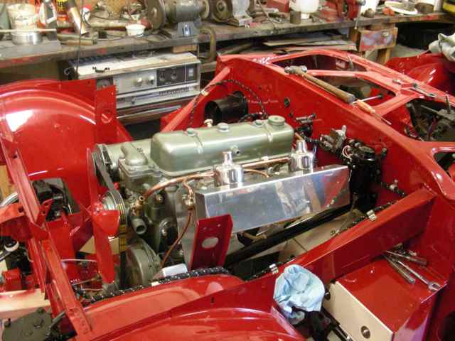

I have one on the BN1 1/2 I am restoring but I haven't fired it up yet so all I can say is it looks good.
Marv J
