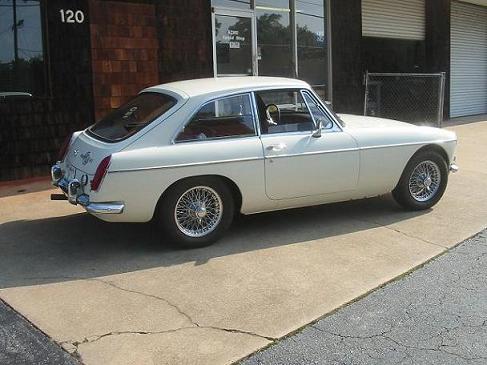

I've got Dayton chrome tubeless spokes on my 67 GT, totally trouble free spoke wheels. Make sure you have REALLY good spline hubs when you replace your wheels.

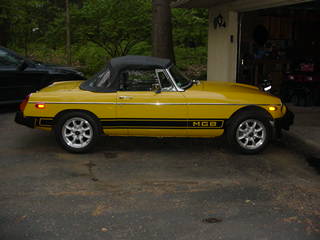

I put 15" Panasports on my 79B. Could not be happier.
Are the hubs bolt on or do you need to get new axles in the rear?
