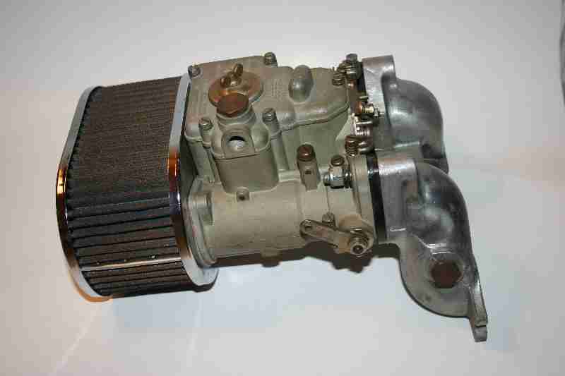

This is an interesting question as I also have in my parts bin a single 40DCOE complete with manifold, stacks and K&N filter, and no throttle linkage. I was also wondering how to rig up the throttle cable.
Supposing for just an instant that it's a good idea to replace the twin HS2s with a single 40DCOE (and there are at least 92 schools of thought on that), you can see in this pic there is the operating lever but nothing to "attach" it to. There is another similar lever attached to the other end of the same shaft.
The fuel union is missing too, but I guess this is easy to replace...
