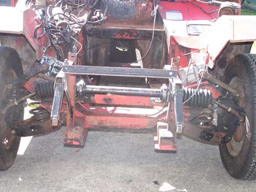

The only cutting done to my Bugeye was to the front cross support (for lack of a better word....I don't know what to call it, but it looks like a 2"x 2" steel rod). This was to give clearance for the crank pulley and was reinforced with a notched plate of steel so little to no structural integrity was lost. The only other thing needed was some new motor mount brackets welded to the chassis. The rest of the mods were to the engine itself, like modifying the oil pan to clear the front crossmember, remote oil filter kit, etc.
If I wanted to I could install a stock 948 back in and you would never know it was ever modified. That's the beauty of my particular swap.....very little cutting was involved.
I will try to find the pics of what I am talking about....a picture is worth 1000 words afterall. :smile:
Here's a pic of the cutout on the front steering rack support. The notched reinforcement is not shown, but it uses the bolts/holes for the steering rack to attach both cut halves together and still give clearance for the crank pulley. This pic was taken almost 2 years ago (I think) and the engine compartment was dirty due to an oil leak. Just had to explain why it's so dirty! :smile:

Great pic MrSprite. I wouldn't worry about a dirty engine compartment, it's much better than my very EMPTY compartment at the moment.
Can't wait to see the other pics. The pic of the cut out has helped my confidence. How did you go fitting the radiator?
I'll try to find the other pics, but I've had several HD crashes over the past year and many are just gone now. The radiator is a stock Bugeye unit that has been converted to a 3 row core. I'll snap some pics of it tomorrow to show you....as far as I know, it mounts up just like a stock Bugeye/Spridget (but I don't own a stock one, so I have no idea how they mount). I do plan on installing a more modern aluminum radiator at some point though. In the extreme heat )100+* F, it runs a little warm. I wind up running the electric fan fulltime on hot days just to make sure nothing overheats.

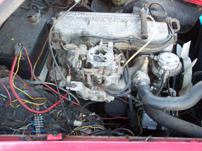

I have a "junker" in the back yard that I bought for parts that has a rather crudely installed Datsun A10 (1952cc) engine and tranny installed. The engine seems to fit just fine (an over-sized radiator caused the DPO to butcher the bonnet!), but the trans tunnel is a total butcher job! I did at one time get the thing running and took it for a short drive around the 'hood
Interesting swap.....just so you know, that is not an A10 (or any Datsun A series engine). If it's a 1952cc, then it's probably an L20B.
FWIW, an A10 is a 1000cc/1L engine.
bugimike
All I had to go by was the engine plate provided by the DPO! On closer examination of the plate, engine type is listed as a Z20! The Datsun type (where I made my error in reading the plate!) is WHLA10! :rolleyes: Not really that familiar with Datsun nomenclature! :smirk:

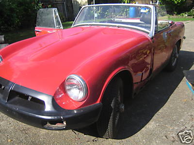

The picture of the Sebring front is in the avatar. If anyone would like to see a closer pick I can supply later. I've just been told that I'm only allowed to upload one picture????

I didn't notice the Avatar pic.
I have the same bonnet but modified with flares.
Do you know who made it? I believe that it is an Aussie one and there aren't too many of them.
