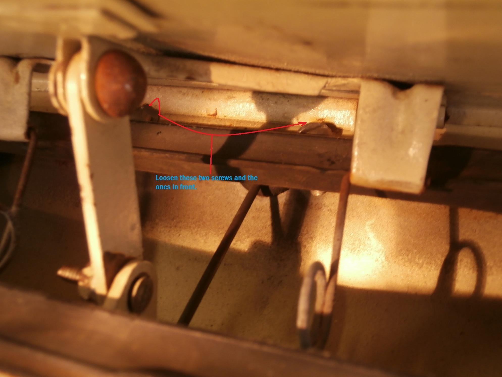

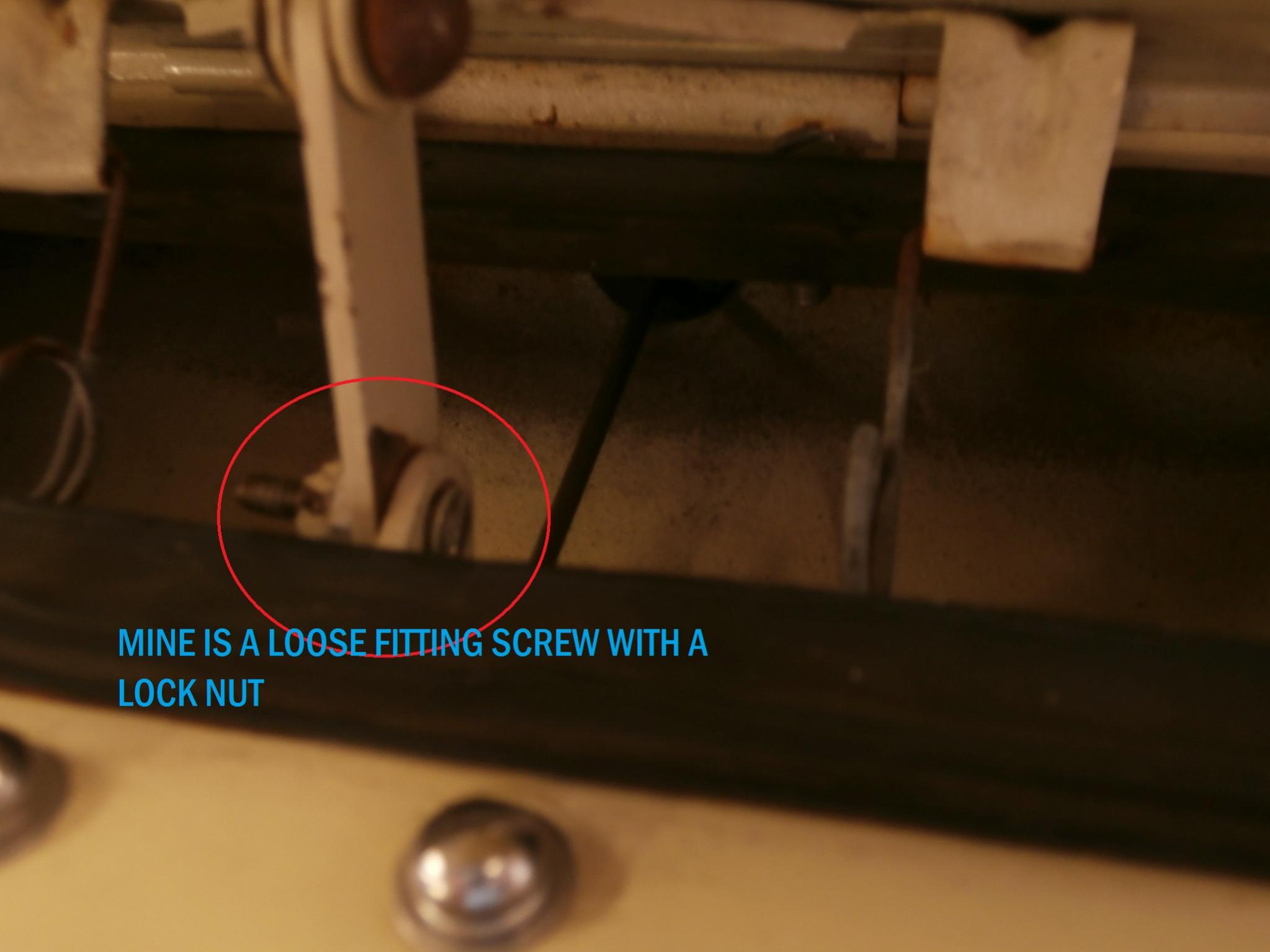

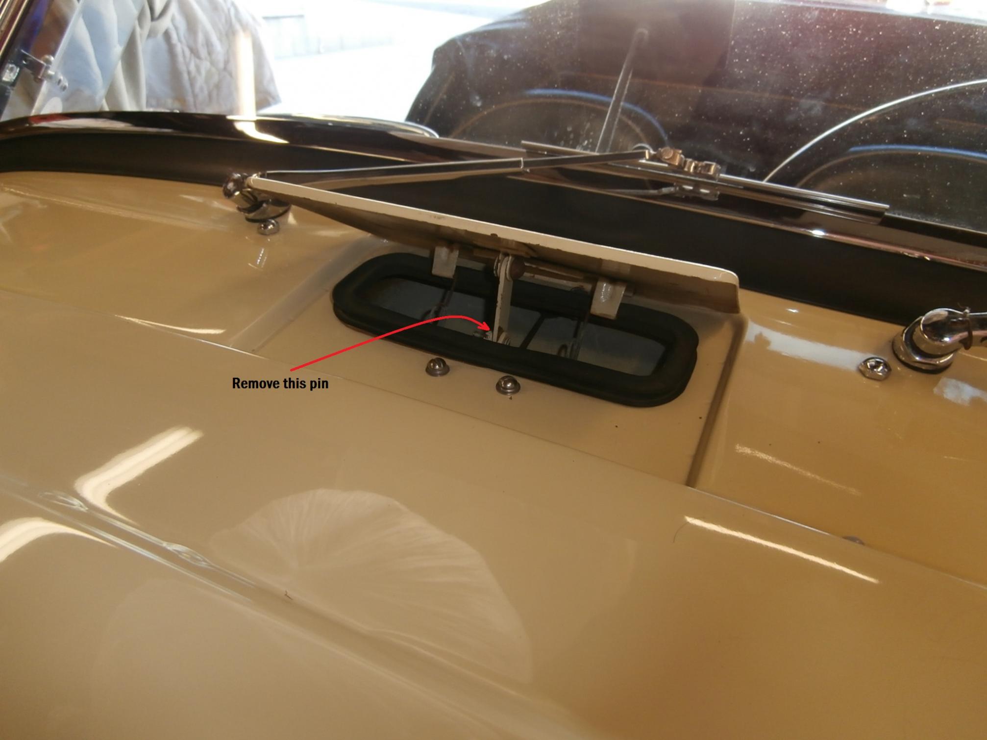

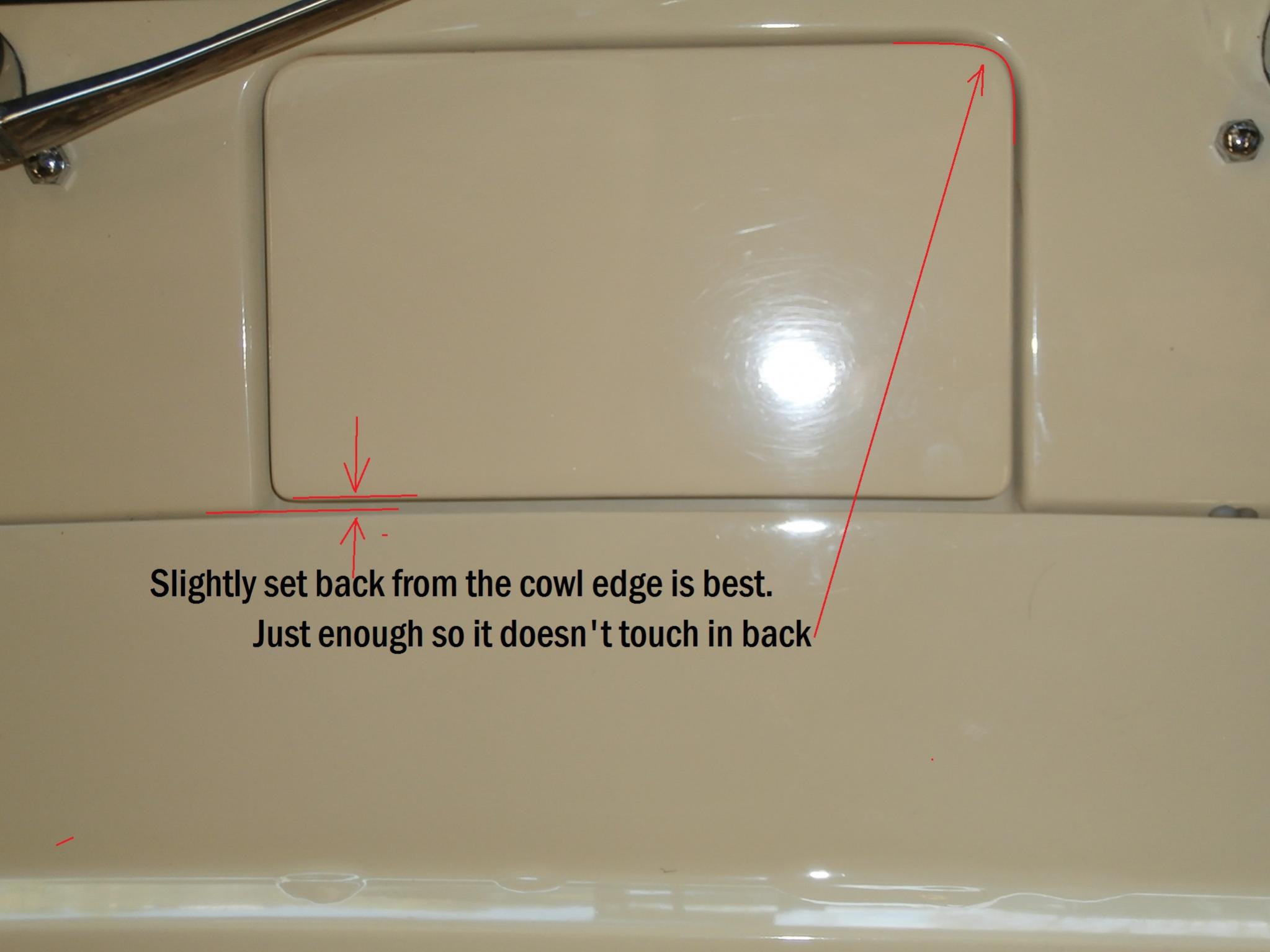

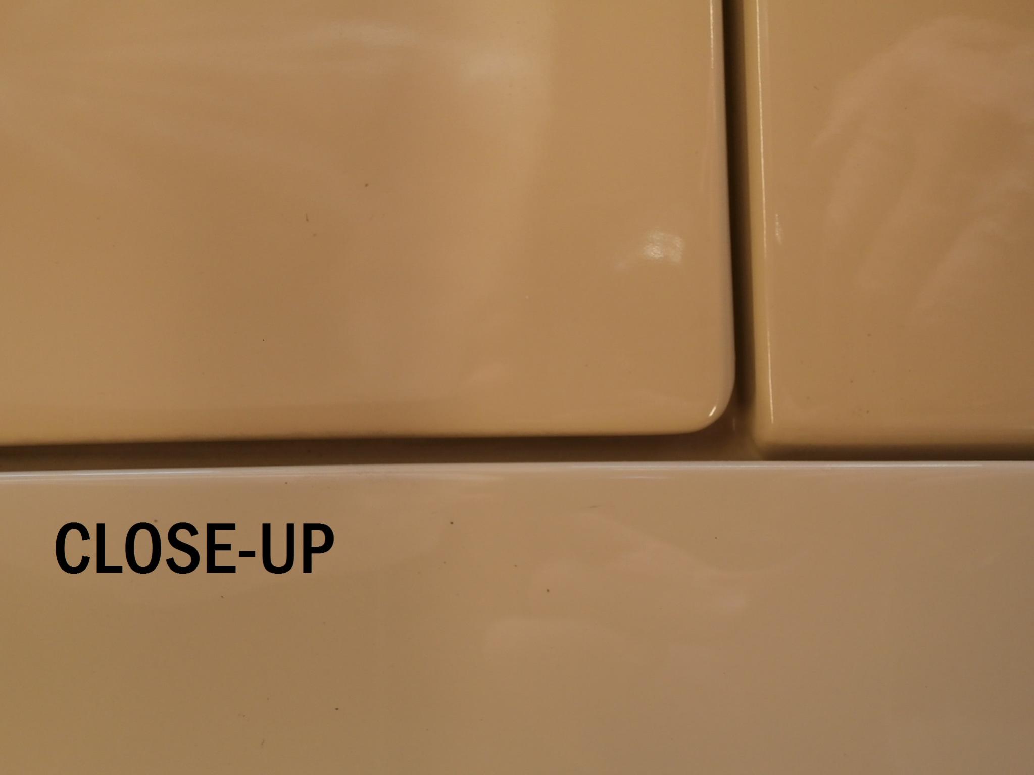

Yesterday I got my Bonnet back from being painted & looks really nice.
My "Cowl Vent Lid" sits a bit high of one side & Interfers with the opening & closing of the Bonnet; When I have it closed.
Where can that "Height Adjustment" be made without pulling the Heater Box???
Thanx Much,
Russ
6TTR3A
Hi Russ,
Usually the problem is the cowl vent cover is too far forward, interfering with the opening/closing
of the bonnet. Some adjustment can be accomplished by loosening the 4 slotted machine screws under the cover. To get at them you need to disconnect one of the pivot pins attached to the cowl vent
opening/closing mechanism. The bottom one on mine was removable but the top one is a rivet.
If you have a height issue as well, the braces that hold the spring to the top of the vent cover
can be bent to adjust height. CV1 & CV2 show the optimum clearance to the bonnet The rest
show the location of the pivot pin and adjusting screws.

"Frank": Thanx for the info. & Pics. Great Help. I thought something probably had to be "Bent / Adjusted" for the correct fit.
